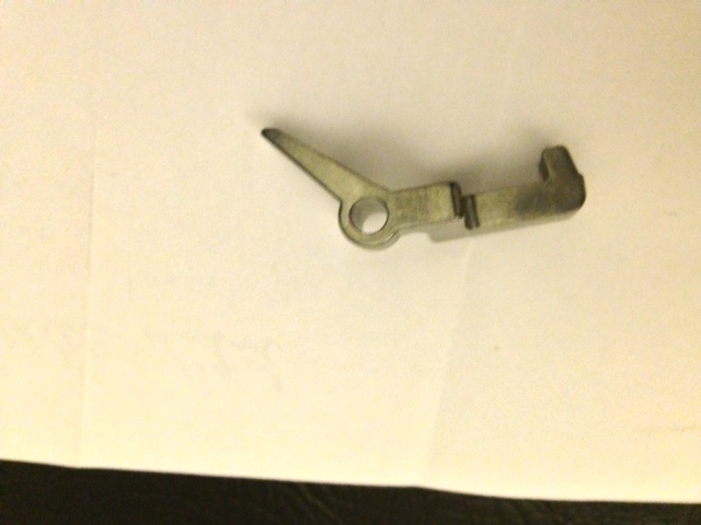

I too have an issue with this part - my camera did not take any knocks but apparently it just broke on its own . I have contacted WTS Video in Barking, London and they managed to find the part for me. I have just been informed today that the part has arrived at their end and will ship it out to me. The cost for the part will be £13.20 Plus VAT and £15 Delivery to Malta. I will let you know how it goes when I receive it next Thursday.
**Updated - actually I've just received the invoice and it has costed me just £14 (VAT inclusive) including shipping! The part no is as follows: Fujinon Lever P47B11976650 **

I just received the part and inserted it this morning. A five minute job and the grip is as good as new!
I am attaching a photo of the packet and the part itself.
WTS did take some time before they answered me. Just write to them again and state the exact part no.
