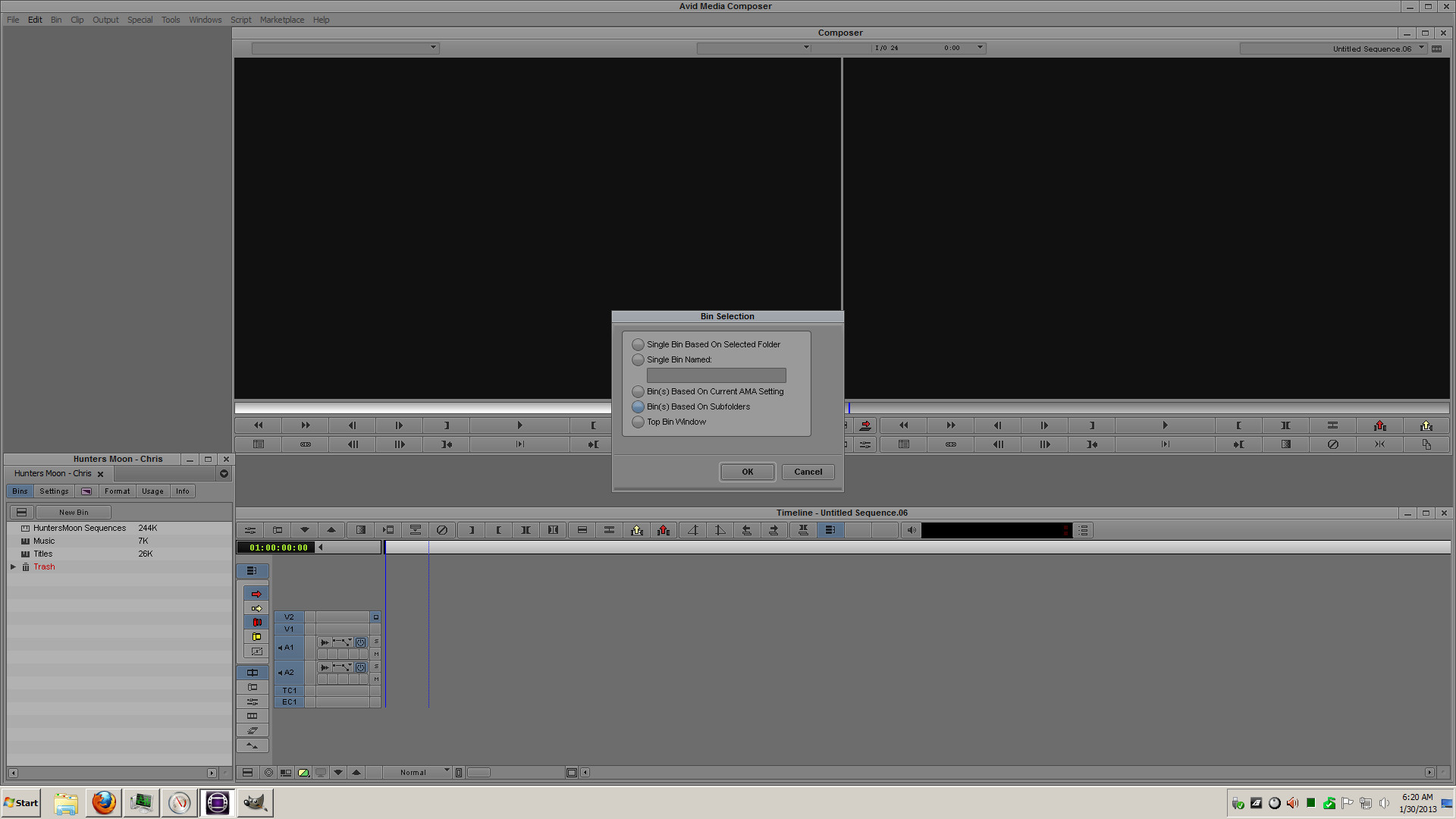

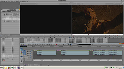

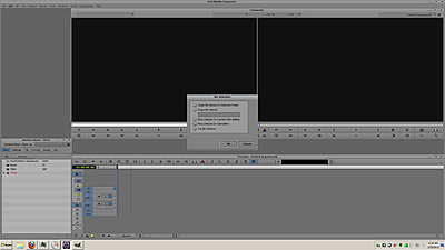

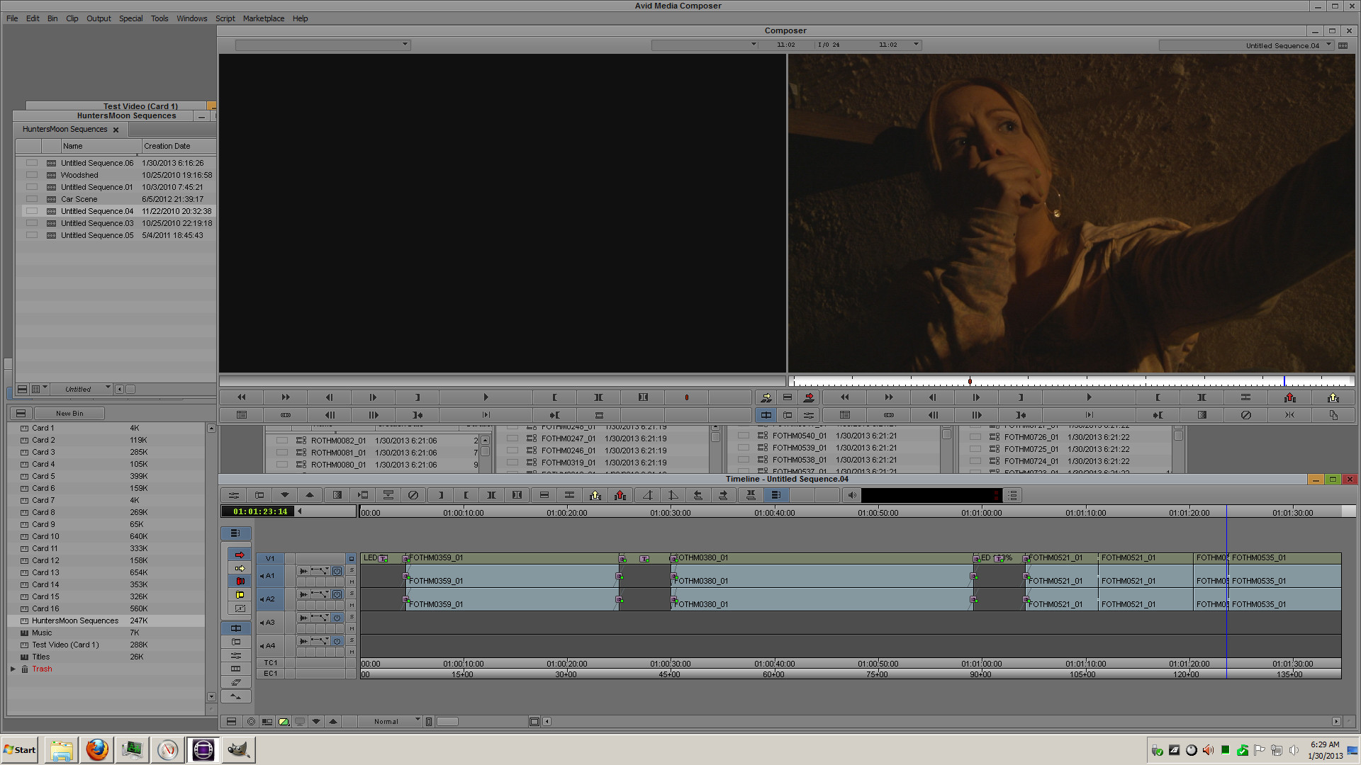

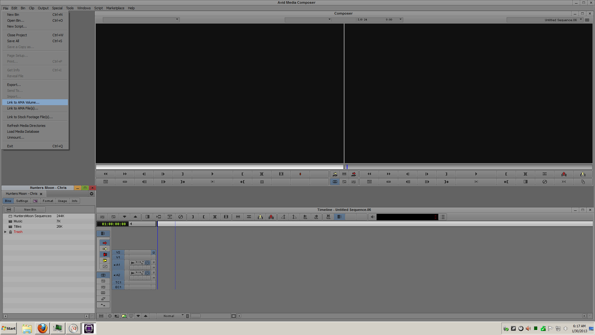

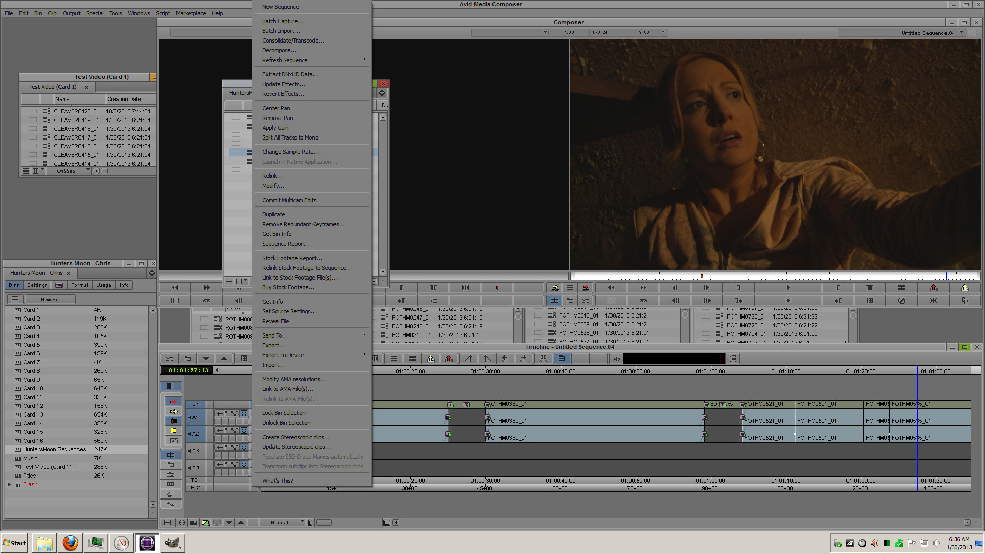

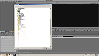

First you have to get your media into your system. I took a large project that I worked on to show how this works with a generous amount of xdcam media shot over a couple month period.
You can step through the attached screen grabs and see what happens pretty easily. In the AMA Result image I did arrange the bins like that. They don't com in arranged in a flat view. Also if I had chosen "Single Bin" in image Create Bins all the media would have been in one bin with in this case hundreds of video clips.
So this is step one to getting your media into the system. If you are using XDCam you can get right to work editing with no problems with performance. There are a few export features that aren't available to you when using long GOP media but those are easily handled with another trick I can show you in another post if you need.

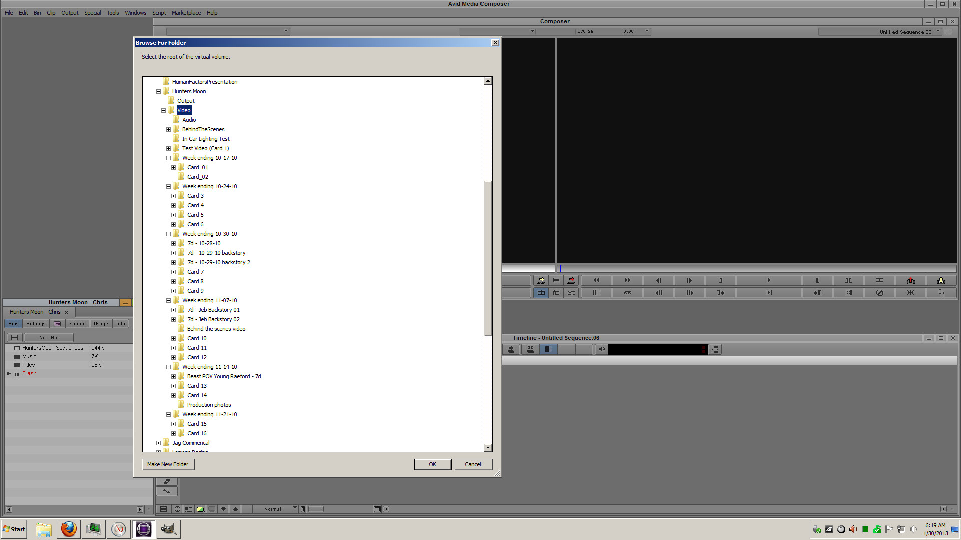

Now one thing I want to point out here is in the attached graphic - Media Works - the media before I started this was OFFLINE because I had deleted it all out to show how AMA linking works. When I relinked everything the system recognized it was the same media even though it was now in a different location on my computer from when the sequences were created (I brought this project back off my archive server for the demo).
Another thing you may notice is there were some folders on the directory tree in image - File Location - that didn't come into the project. Those are folders with Canon dSLR footage. You must use "Link to AMA File(s)" to pick up those.
On to the next part.
PMW-200: exporting clips for import into Avid.  Advice?-01-linktovolume.jpg   PMW-200: exporting clips for import into Avid.  Advice?-02-file-location.jpg
PMW-200: exporting clips for import into Avid.  Advice?-03-create-bins.jpg   PMW-200: exporting clips for import into Avid.  Advice?-04-ama-result.jpg
PMW-200: exporting clips for import into Avid.  Advice?-05-media-works.jpg
http://www.LandYachtMedia.com

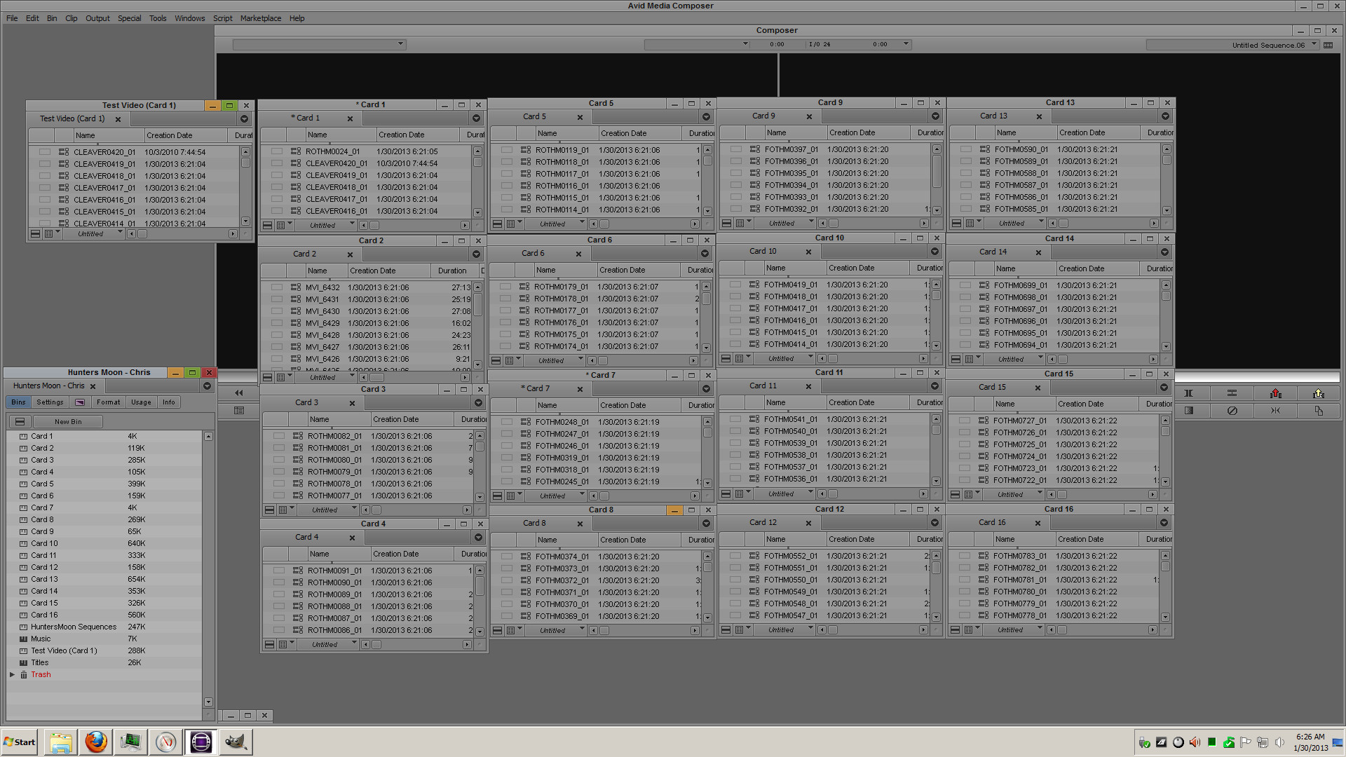

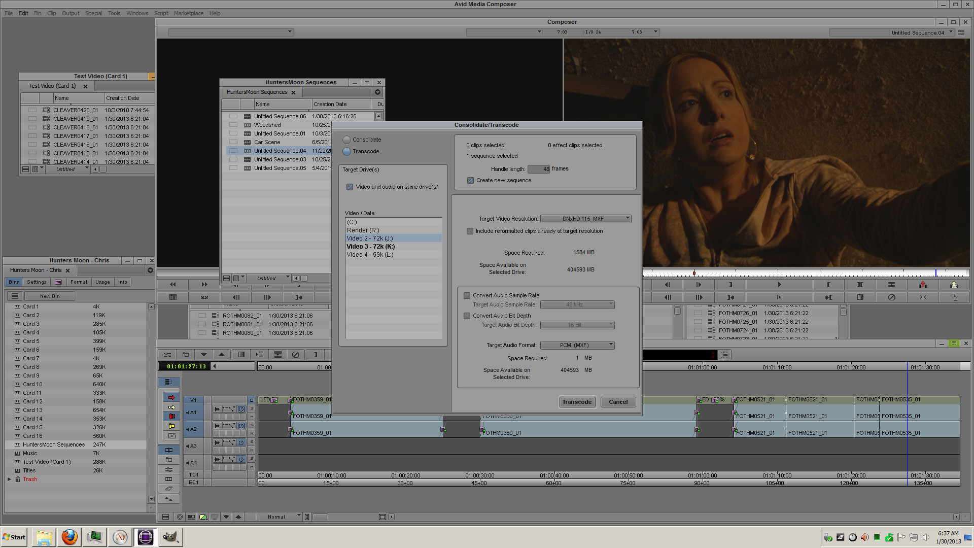

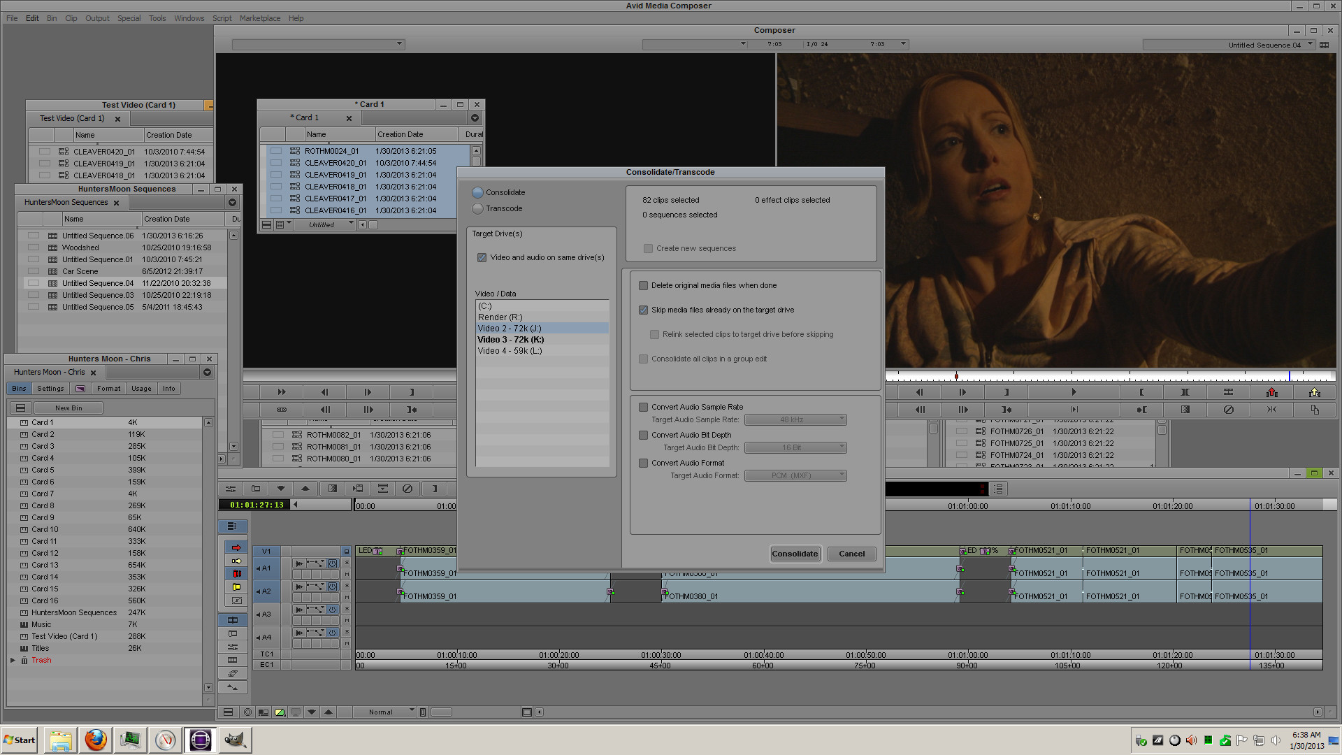

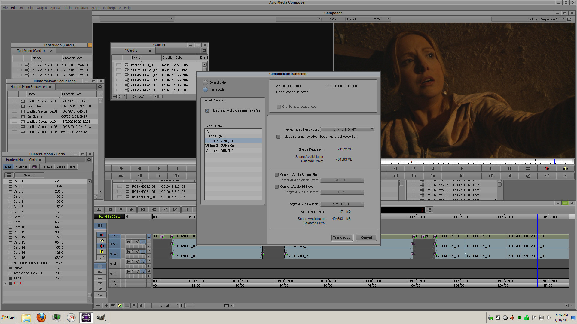

If you do need to transcode things you have some options. You can transcode files in a bin as you can see with attachment #10. This transcodes everything you select in the bin. Depending on your project that may not be an ideal situation. I chose this project to demonstrate that because it is a dramatic piece and has several takes of the same thing. I may not want to convert everything and tie up that much hard drive space with less compressed media that I'm not going to use in the project. At 35mb this project is 300GB of RAW video. It would be easily 1.5TB if it was transcoded to DNxHD.
To trim down the media to just what I plan to use I drop it into a sequence and do a rough edit. I'm not worrying here about a final result. Just doing some housekeeping. You can see a sequence loaded in attachment 07 and the transcode dialog. The drive on the list you see there in BOLD is where the AMA linked media is currently located. A quick note here - If you are going to transcode media make sure you do it to some OTHER drive. Don't have AMA linked and identical transcoded media on the same drive. That can lead to confusion as to which media you are working with. It also makes it harder to go back and relink to the AMA files for final render if you wish to do so.

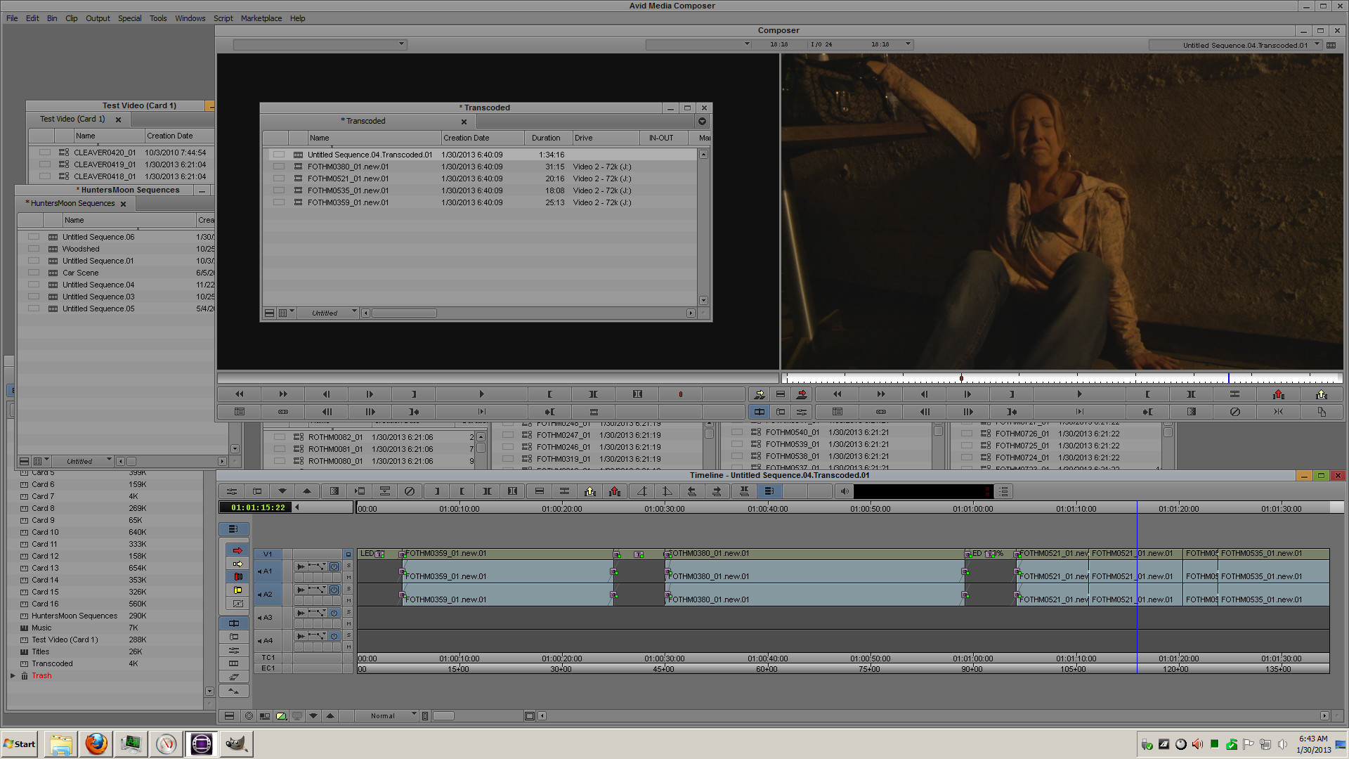

Once you transcode the sequence you can see in attachment 08 that Avid has created the new transcoded media and a new sequence with the new media. It will be functionally equal to the sequence with the linked AMA media. If you don't want a new sequence with the new media then simply uncheck the box "Create new sequence" you can see in attachment 07.
That is the basics of how to do it. We can continue the discussion as to why you might do one over another if you have any thoughts or questions about that.
XDCam is a very mature codec. I would recommend giving a direct AMA (non transcoded) worflow a try. If you don't like it you can easily transcode your sequences and not loose any editing work.
PMW-200: exporting clips for import into Avid.  Advice?-06-transcode-sequence.jpg   PMW-200: exporting clips for import into Avid.  Advice?-07-transcode-sequence.jpg
