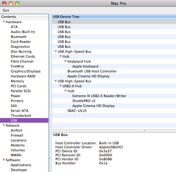

It's an outside shot but I've had problems with USB devices out of the blue. For me it was a keyboard that was causing the problem on the USB buss. Disconnecting ALL USB devices except the EX1 may show you the camera is just fine. Also, the Apple System Profiler (Apple Menu -> About this Mac -> More Info) may show if the underlying hardware is seeing the camera.

Tried it - no luck. As I said, I tried to connect the camera to 3 other computers with the same result, so it is not computer.
