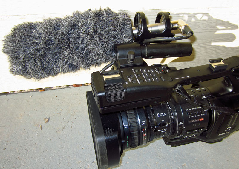

Jim,
I keep my Rode NTG-3 on the camera pretty much all the time unless I attached a wireless lav set. I use a shock mount (Rode SM5) that extends the mic far enough back and far enough out that it doesn't show up even when using a wide-angle lens. I wrap a couple of rubber bands around it to make it fit snugly inside the camera's mic mount. Just have to check the bands every so offten to make sure they're not about to break. (From looking at the picture, I think it's about time I checked again!)
I also have the NTG-2, but don't use it anymore because the sound is considerably better with the NTG-3. The NTG-2 is still a very, very good mic and much cheaper than the NTG-3. You would be happy with it.
If you decide to get an NTG-2, let me know. I've been thinking about selling mine for quite awhile now. :)

Just thought that with the SM5 shock mount, you would be able to use your AT897 just fine without a windscreen of any kind because it could be mounted back.
With the dead cat, my NTG-3 is at the limit and, since it's 1" shorter than the AT897, a windscreen would probably show up in your shots.
This setup also allows me to use the mic with a HDV-Z96 light mounted on the front shoe. The dead cat does block a little of the light in one corner no matter what I do -- probably not noticeable unless shooting a solid, continuous background -- but when shooting with the light, I'm likely indoors and the dead cat can come off allowing the mic to be mounted back so as not to be visible.
