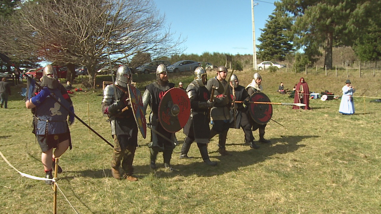

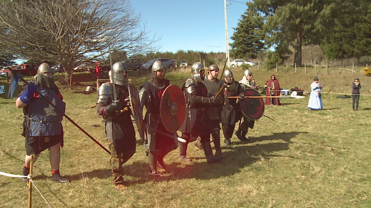

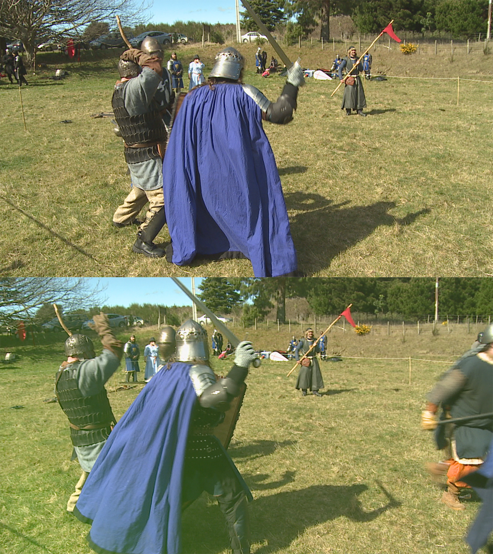

Had this camera for about 9 months and never seen this issue before but when filming some Medieval fighting the other day I got this strange red or green color cast in some of the clips.
Seems to last for at least a second then just comes right. As I was on and off the tripod all day I forgot sometimes to turn off the image stabilizer when it went back on the tripod. Not sure if these shots had the stabilizer on. All the shots that had this problem were on the tripod except for one handheld shot. Sun was behind the camera. What is likely to be the problem here as I have never seen this before on this camera or my previous EX1.
Sony PMW200
Pal HD422 50/720/50p
0 gain, no shutter, 6100wb, manual aperture and focus.
YouTube clip of the problem clips here:
Strange color cast Sony PMW-200-color-cast.jpg   Strange color cast Sony PMW-200-no-color-cast.jpg

Thank you guys for your suggestions. Guess the only way to figure this one out is to send the camera back to Sony Servicing. It does look a lot like a light leak. If you look at the attached pic you can see that the green color cast seems to be through the whole frame including the trees at the top right taking on a washed out green compared with the unaffected frame. I don't think temperature was an issue as it is late winter here in New Zealand and the temperature only got to 12C that day.
