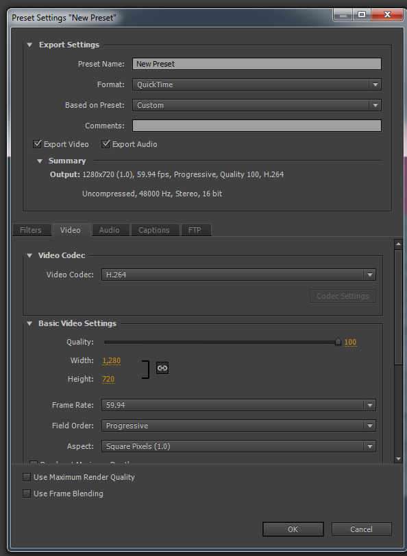

If you have Prelude, you should have Media Encoder? Any and all options you need for Quicktime are readily available there.
