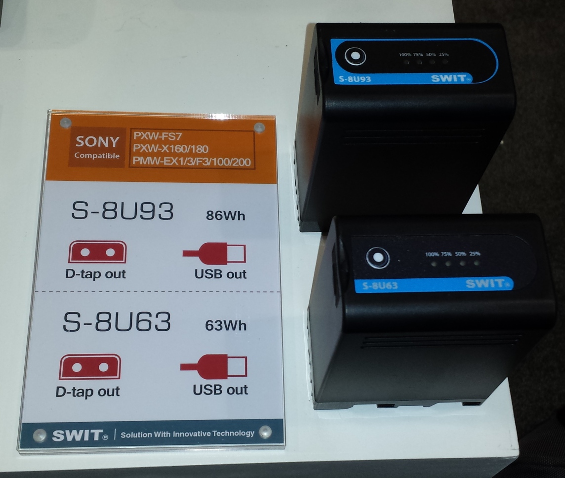

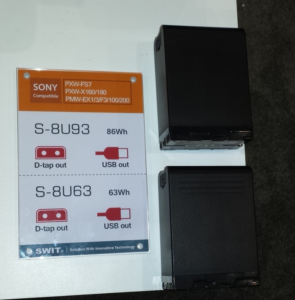

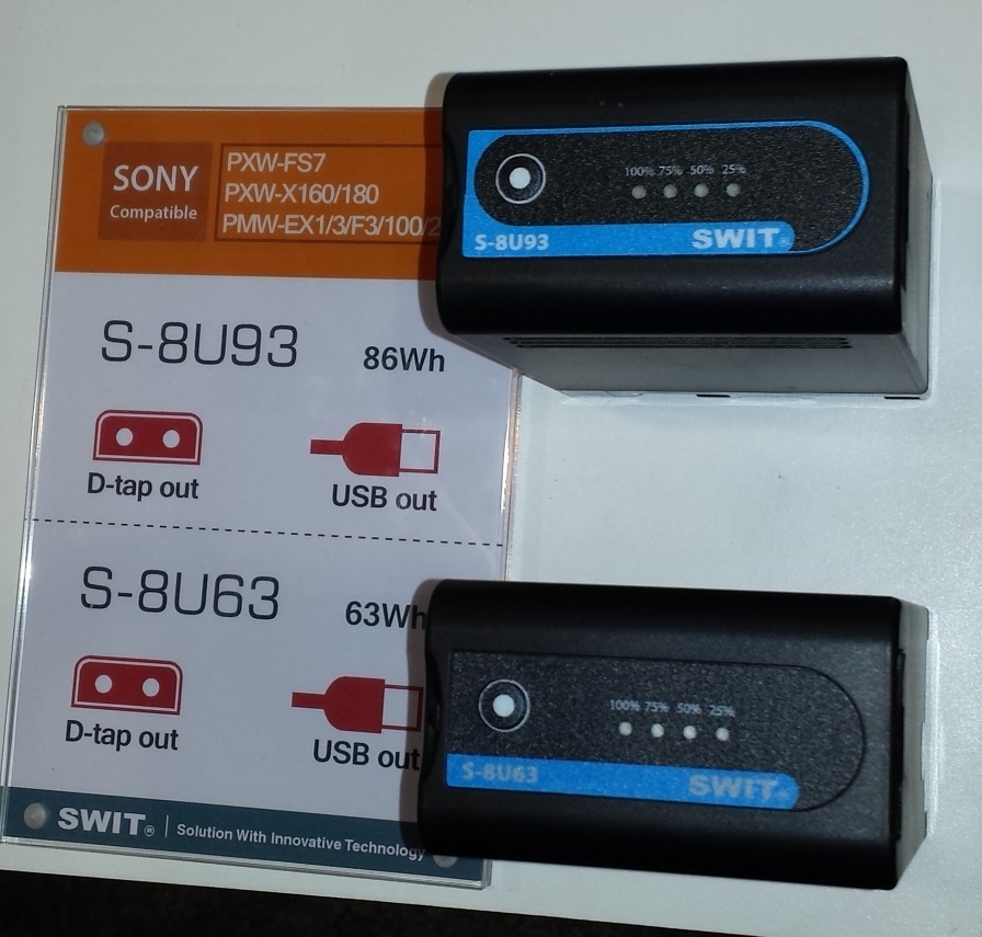

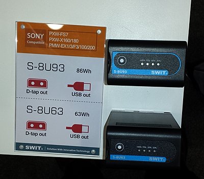

Old April 15th, 2015, 06:42 PM   #37
Contributor
Join Date: Oct 2001
Location: Lexington, Ma
Posts: 286
Re: my pmw-300
SWIT is introducing a bigger brother to their S-8U63 battery, it is 86wh capacity, the same size and weight as S-8U63. D-tap/USB. Will be shipping later this Spring.

Old April 16th, 2015, 04:46 PM   #38
Location: Burnaby, BC, Canada
Posts: 3,053
Re: my pmw-300
Very nice! I'll be getting the 93 to future proof myself in the short term while selling my Switronix & Swit S-8U62 to finally rid myself of pigtails. I did jump the gun and bought a 63 before they updated them for the later cameras, but you can never catch up if Sony decides to keep changing the protocol.
