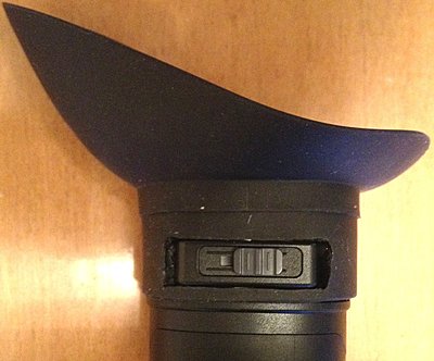

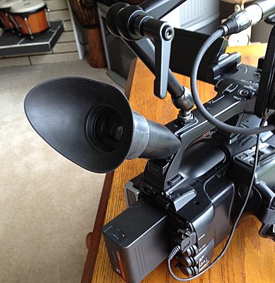

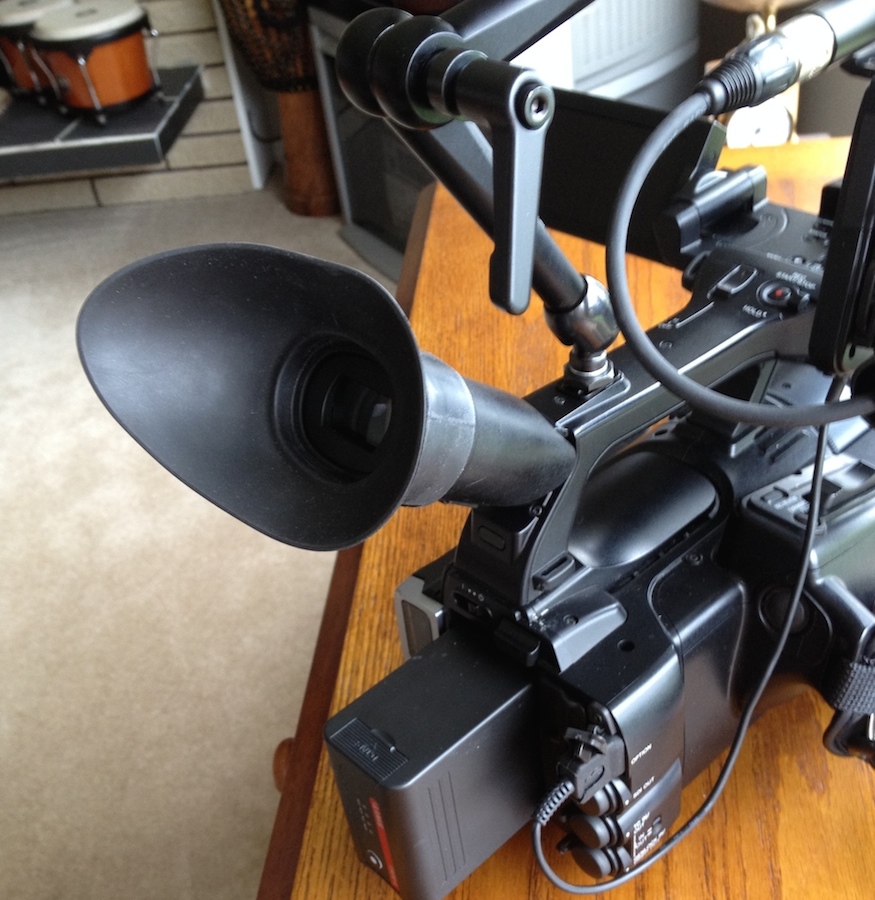

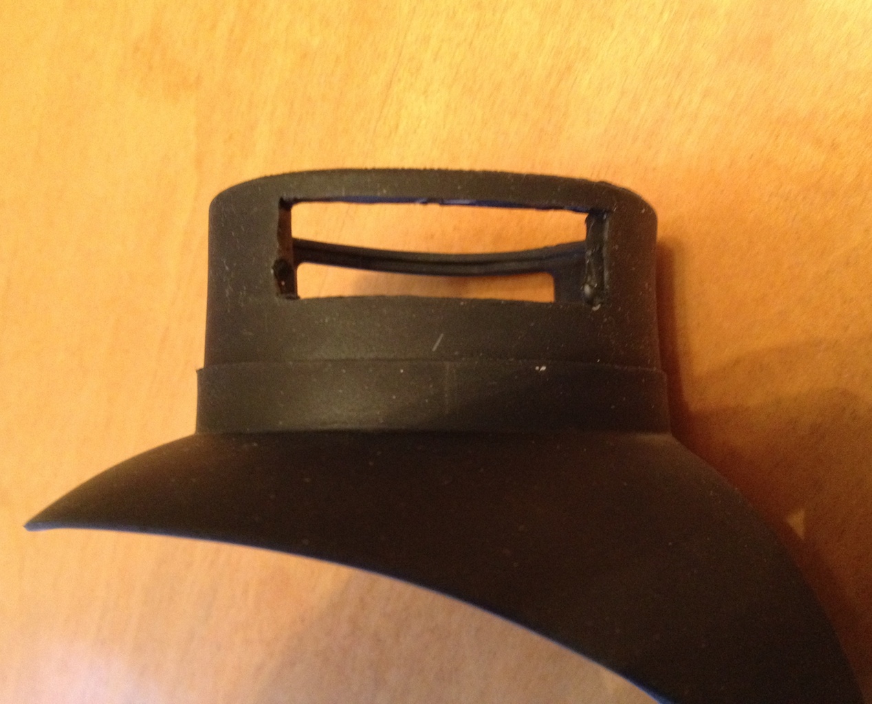

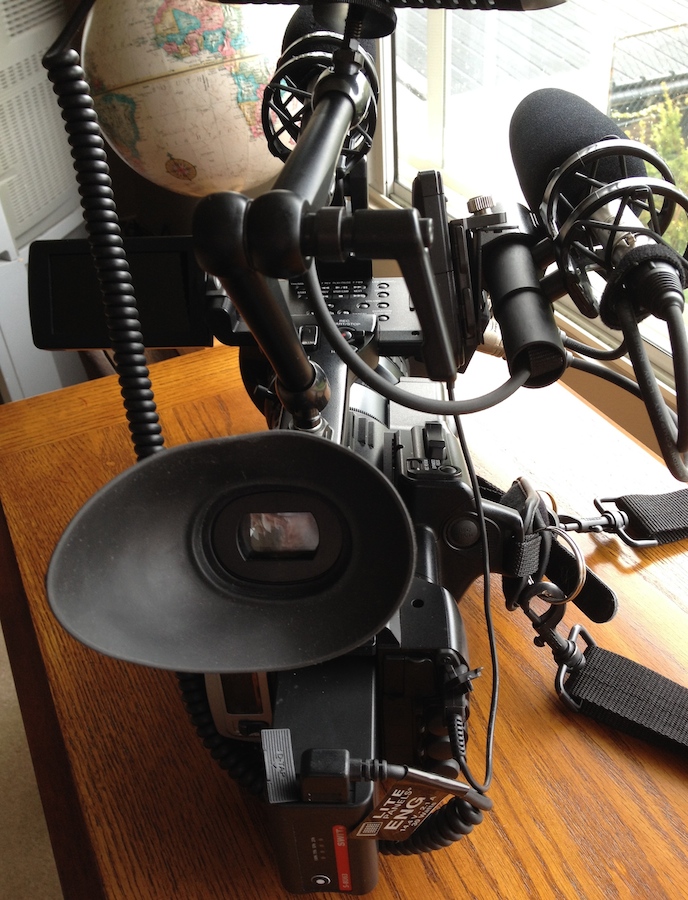

I love my PMW200 but I have three issues: 1) Would like more zoom, 2) Do not like the long menu journey to Slow Motion, and 3) the right eye only eyecup.
The Eyecup:
Wiki says about 30% of the population is left eye dominant. There’s a lot of science about ocular dominance and laterality as to why this is. Wiki also says the vast majority of the world’s very best videographers are almost always left eye dominant.
Ok, that last statement is an outright lie. But….I was quite ticked off when I found out my Sony PMW 200 only came with a right eye dominant eye cup. I am left eye dominant, with the need for glasses for longer distances. I also have a mild cataract in my right eye, which is also not as good as my left eye, anyway. No point in training my right eye with an eye patch.
Too bad, so sad, says Sony. And no one I talked to at shops knows of an appropriate after market replacement. I shoot wildlife outdoors, day and night, so this was completely unacceptable to me. On bright days shooting outdoors I am lost without the cup.

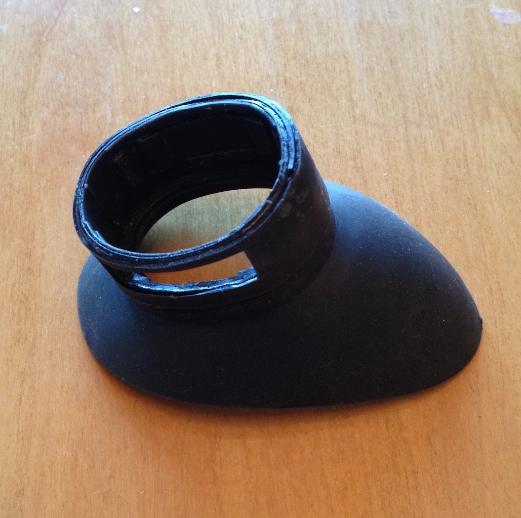

The eyecup cannot be flipped inside out. It is not reversible and due to the diopter placement, you cannot turn it upside down. On top of that, the eye cup body is a little short and too soft – you can knock it off without much trouble, I have a seen a review on this issue on line and it is correct in my view.
So, here are my solutions, maybe a little bush but it works really well. See pics below:
1) Using a sharp exacto blade, I cut out a diopter slide hole on the top of the eye cup, identical to the bottom.

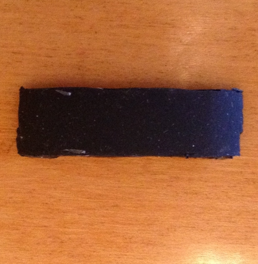

2) Bought some rubber cement and salvaged an old bicycle inner tube.
3) Cut out a length of the tube to match the outside dimension and width of the cup.
4) Roughed the gluing surface of the inner tube, glued the cut out rectangle piece to that.
5) Glued the entire inner tube piece onto the outside of the cup, placing the cut out piece in the old diopter rectangle hole, for strength / durability / flexibility.

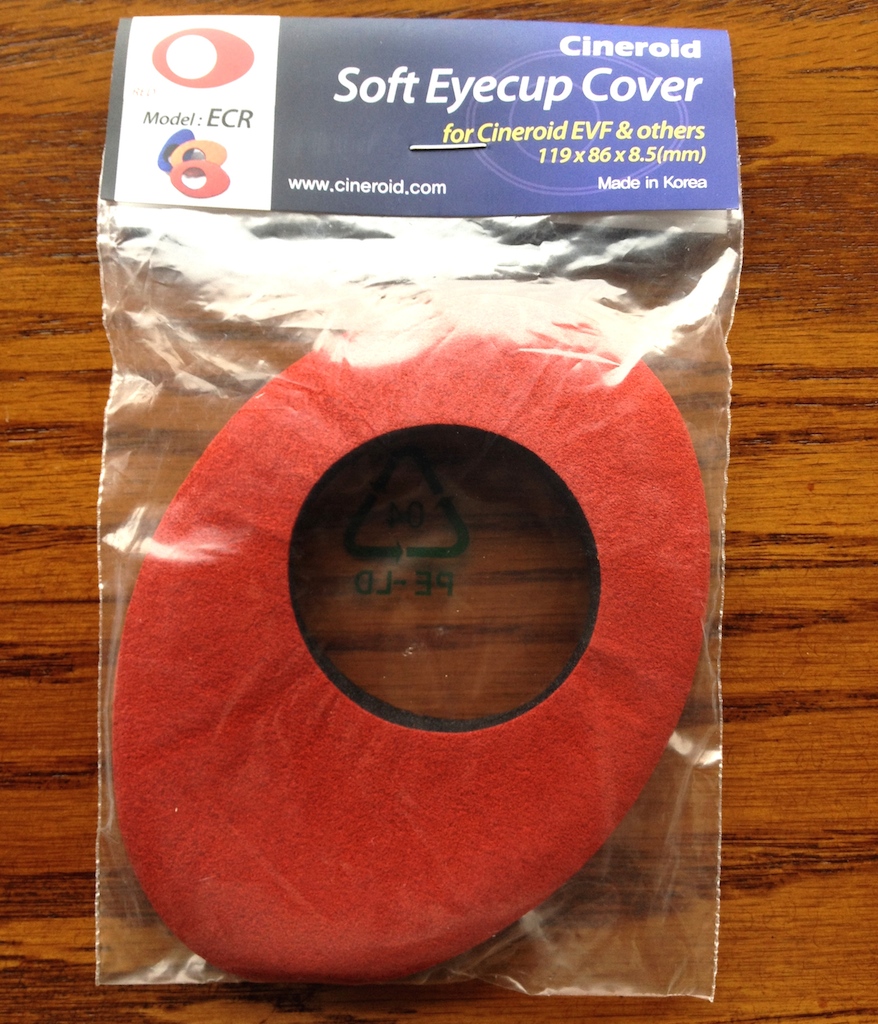

I use eye cushions as per the pic so I can use my glasses instead of contacts. My refurbished left eye cup is far more rigid on the body now, so much harder to knock off. If you lose one, it's going to cost you about $80 to replace it.
Not as professional as Sony could make but it works great and only cost me $2.00 for the glue.
