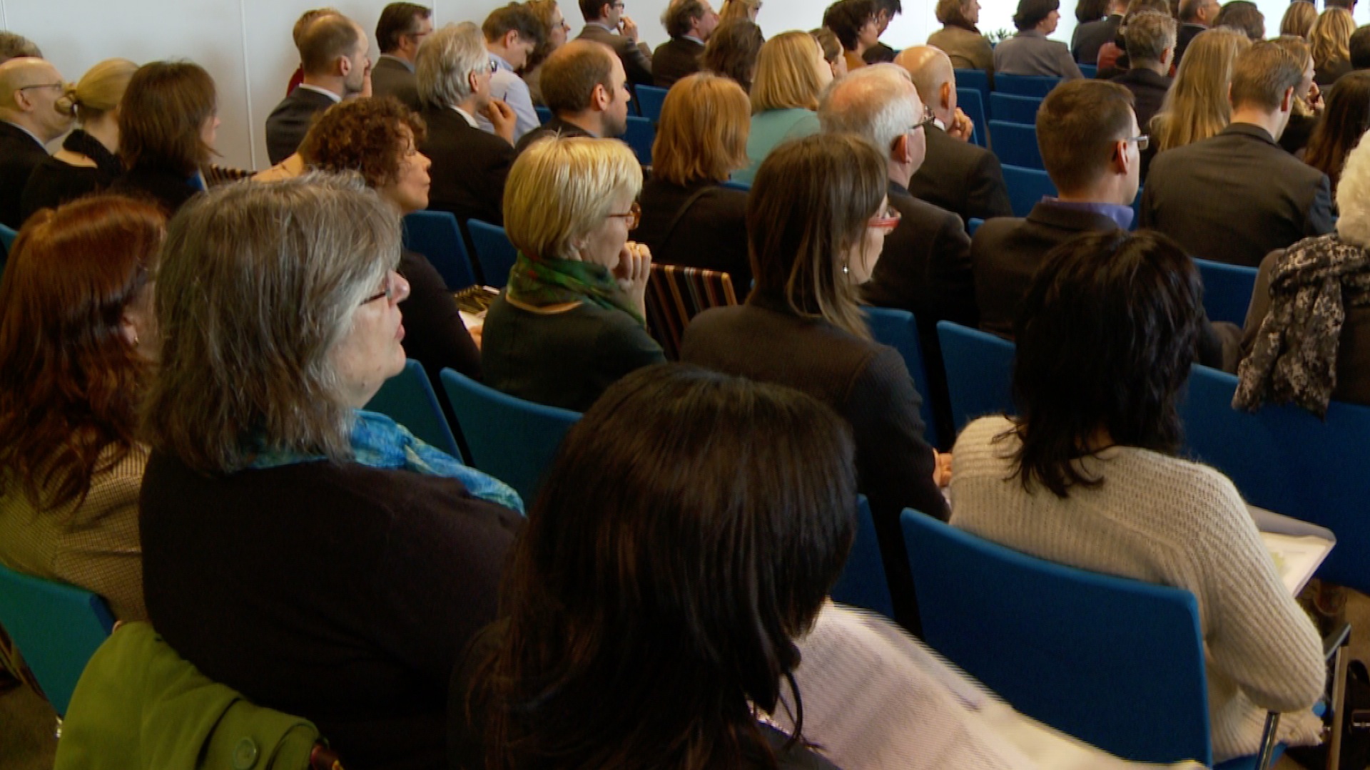

Noisy EX3 shots
I lately notice a lot of noise in the dark parts of my shots. As you can see in enclosed still.
This is shot with the EX3 gain on 0 - 1080i - shutter speed on 60 - using the pp Doug prefers.
Normally I shoot on -3db and shutter speed off but al so then there is noise visual.
Any ideas?
TIA

Here is the still

Re: Noisy EX3 shots
If you are talking about the noise in the blue seat back, that looks pretty typical of an EX3 in a mid-to-low light scenario to me.
The 35mbps codec is a reasonably noisy one, especially when compared to the 50mbps mode of the PMW200/300 cameras.

Hi,

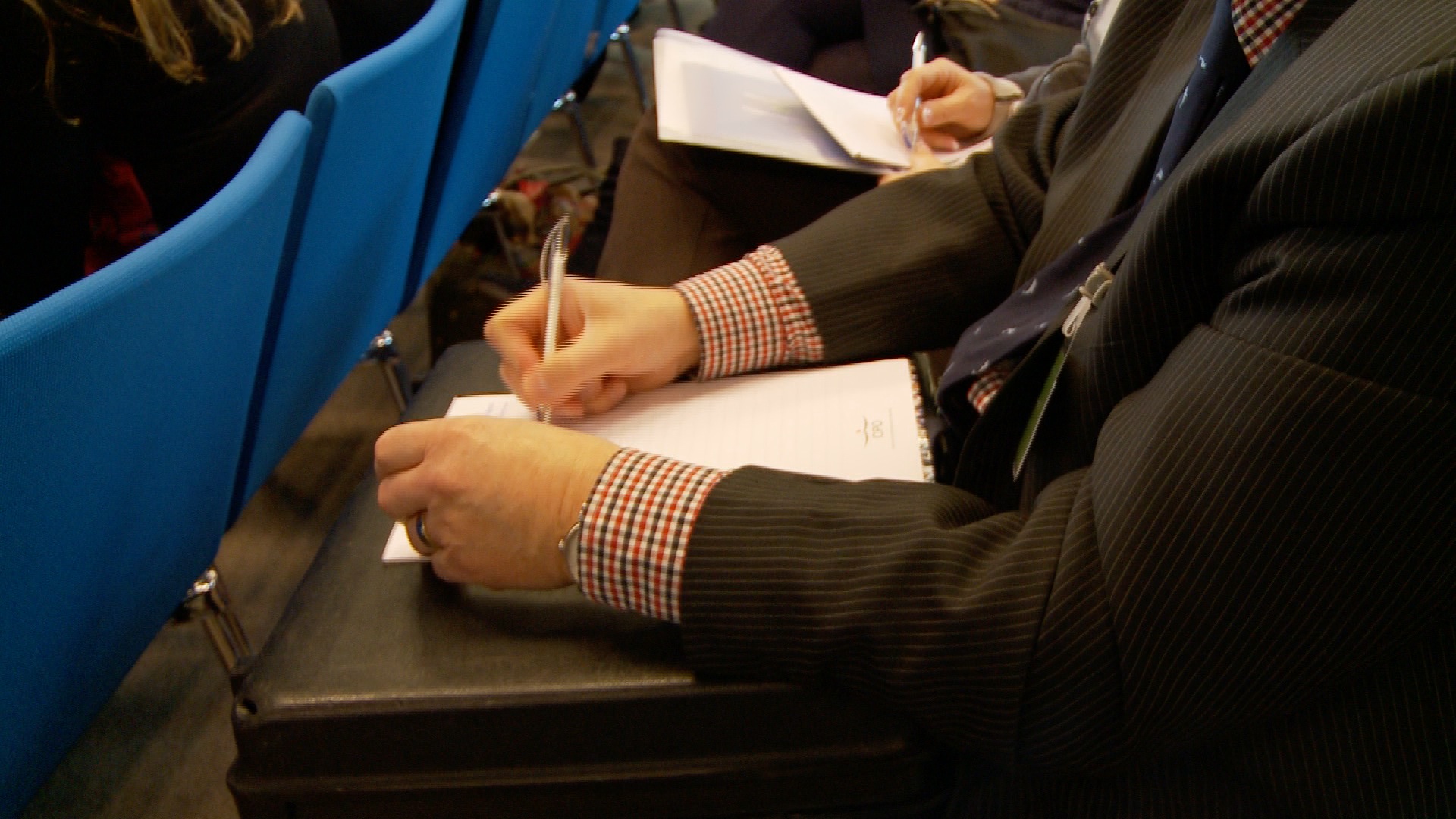

Yeah it's shot in a low light situation. But I had the idea that if I could hold the gain on 0 with iris on 1.9 it would be ok. No picture profile can change this I think.
Attached another still.

Re: Noisy EX3 shots
Did you by chance shoot this with CINE4? That gamma curve lifts the dark areas and will make the noise a lot more noticable.
To minimize the look of the noise in the blacks it is best to use a gamma curve that lowers the blacks such as CINE1.

Re: Noisy EX3 shots
Yes it's on CINE4. It is the recommended setting for overall shooting in the Field Guide I have. But I'll have a look at a setting which will handle low light better.

Re: Noisy EX3 shots
CINE4 is better to boost the bottom end which leads to a better image in low light. Noise will be more apparent using that curve. Use it only when necessary.
