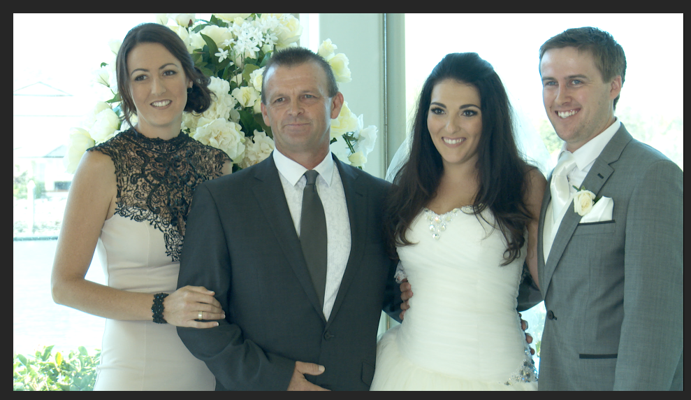

Hi, Can any one tell me why i continue to get a green cast, the Image on the LCD looked prefect on the day, yet what i see on the card is different..
Rob.

Never trust the LCD. Looks like the WB was set to fluorescents and you had sunlight.

Looks like there is some light coming from fluorescent or LED lights. Maybe ceiling lights?

Thanks, is there Setting for fluorescent or LED lights ?

I use the minus green card in my Warm Card set from Vortex Media whenever I know there are fluorescent lights around. It will take care of the problem you had.
WarmCards - White Balance Reference System
I'd suggest the only "setting" to deal with is paying a little more attention to your white balance.
