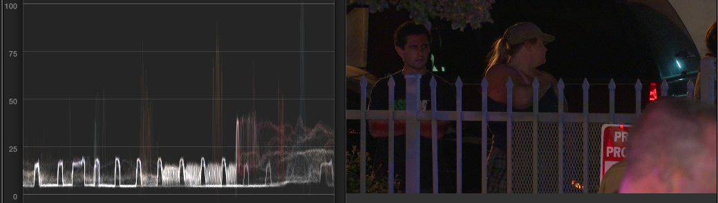

While you are here Chris, can you take a look at the clip from something I shot last night. On the waveform and vectorscope, I never see my blacks go to 0IRE. On my X70 footage, I do see 0IRE stuff in the blacks. Is my master BLACK needing to be knocked down -2 or -3, or is this normal? That was shot without the black gamma adjustment, and BLACK is ON but no adjustments made. I noticed things get a bit lighter in the darks with black "on".
X180 will not allow BLACK GAMMA adjustments-screen-shot-2015-05-05-11.09.17-pm.png

Normally at 0dB I would cap the lens and check the black levels on a WFM. As a starting point I'm usually happy adjusting the Black level to about 15mV above blanking (black level) which of course sits at 300mV. So capped black at 315mV. 0-300mv being syncs of course. That's black levels we are talking about. Black gamma is obviously going to affect dark levels above this right up towards the mid levels of the gamma curve.
For shooting in the States if you are using the STD gamma curves I would guess you would generally use STD5 R709. if you using the Hyper Gammas I guess you would select HG4 4609G33. The Hyper Gammas are obviously going to give you more dynamic range. The HG4-4609G33 breaks down to meaning you are going to get 460% more dynamic range with a max recording level of 109 IRE and with mid level grey sitting at 33 IRE.
Many things can effect the perceived 'blackness' in an image. Shooting down the light gives you the greatest perceived contrast and black levels. Shooting across the light makes the image look not so contrasty / black. Shooting against the light often lifts black levels as perceived by the sensor due to lens characteristics, flare etc. In studio setups we used to compress the gammas on the side cameras as opposed to the central cameras because the side cameras didn't look quite as 'black' in the lower end because they tended to be shooting more across the main lighting from the grid.
It's all a 'Black Art' so adjust for the best results. The HG4-4609G33 Hyper Gamma selection will or should give you the max you can squeeze out of the camera but in the end a lot of it comes to to subjective assessment as to what you like your pictures to look like.
Check out Alistair's page on Correct exposure levels with Sony Hypergammas and Cinegammas it will give you some good pointers.
