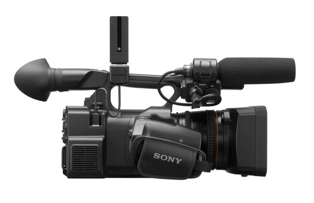

Old August 16th, 2015, 03:30 AM   #4
Join Date: Jan 2013
Posts: 1,559
Re: X180/X200 live streaming
Here is what the new unit looks like with the 5Ghz WiFi module.
Paul
X180/X200 live streaming-cbk-wa02_cbk-pxw-x180-1200.jpg

It hasn't been released yet, I just found a picture of it on an X180. There is a planned firmware update for Autumn (Oct-Dec) 2015 which will include network updates for the new WiFi module, as well as 8K 14 bit 4:4:4 XAVC-i :-)
I am "ok" with the X180 live streaming. The main issue I am having is that Sony will only enable the camera to operate with 1st generation LTE Verizon (Cali-USA) which can only be found on eBay used. The second generation XLTE and newest 3rd generation XLTE (XLTE = 3Mbps upload, LTE is only 1.5Mbps) will not work with the Sony cameras. JVC's don't suffer this problem.
