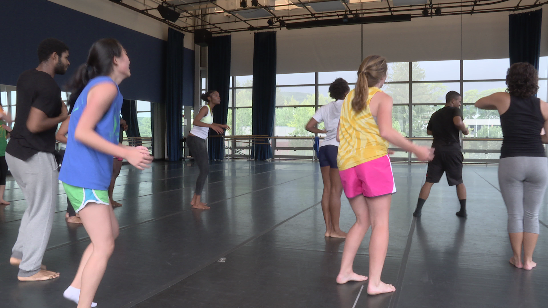

If you look at this picture you will see the worklights on the top. As sunset comes there is a constant need to re-adjust the kevin from 5600k to 4100k During a performance there is no ability to re white balance.
My previously owned Sonys did allow WB (Z5, Z7, FS100, etc...) simply by pressing the while balance button while in preset mode and then using the menu dial.

In my opinion, and 35 years of shooting stands behind it, mixed lighting situations do not require the ability to dial in a random kelvin number. Other people may disagree, but I myself have never needed that particular feature on any camera now or before. Even if you dial in a number, you still have the mixed lighting situation to deal with. But I contend that dialing in a random number may just dig you a deeper hole because it doesn't address Green-Magenta, you can't really tell from the viewfinder what you are getting, and dialing in a random number does not take into account the true color temperature of the prevailing light.

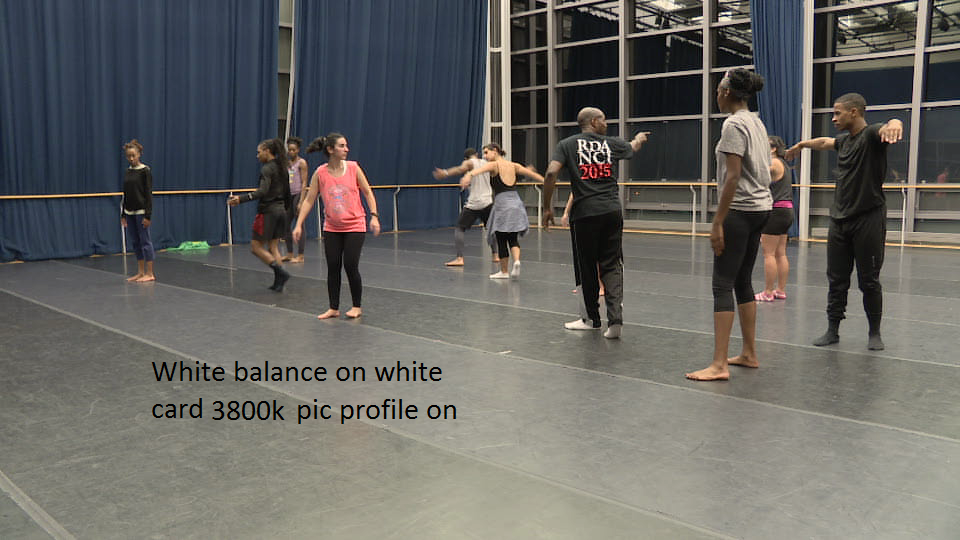

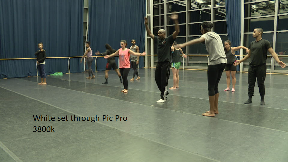

Doug I am not really talking about different light sources I am talking about changing light (daylight to incandescent) during either sunset or on a cumulus cloudy day (bright sun to darker overcast within minutes while indoors with windows and incandescent lights also on). I am pretty experienced at looking at a lighting situation and judging what the white balance will be before I even color balance. I just want to be able to access the wb controls without going through pic profiles. As I stated earlier, this is something that could easily be done on many Sony cameras such as the Z5, Z7, FS100, FS700 etc.
My other concern is when the white balance is done using a white card and then the picture profile is set to the same temperature, A/B between the two are very different looking, This make no sense to me. see pictures.

Your pictures just display exactly what Doug and Bruce are talking about.
When you white balance using a card it adjusts not only the Red-Blue kelvin setting, but the green-magenta balance as well.
It looks like the light sources have a significant green spike in their spectrum - which the white balance is compensating for. Preset settings are designed for smooth spectrum sources such as daylight and tungsten, not for overly green sources such as fluorescents and emission bulbs.

Interesting however I am not sure why I have not experienced this phenomenon with other Sony cameras or why it also does it in daylight.
