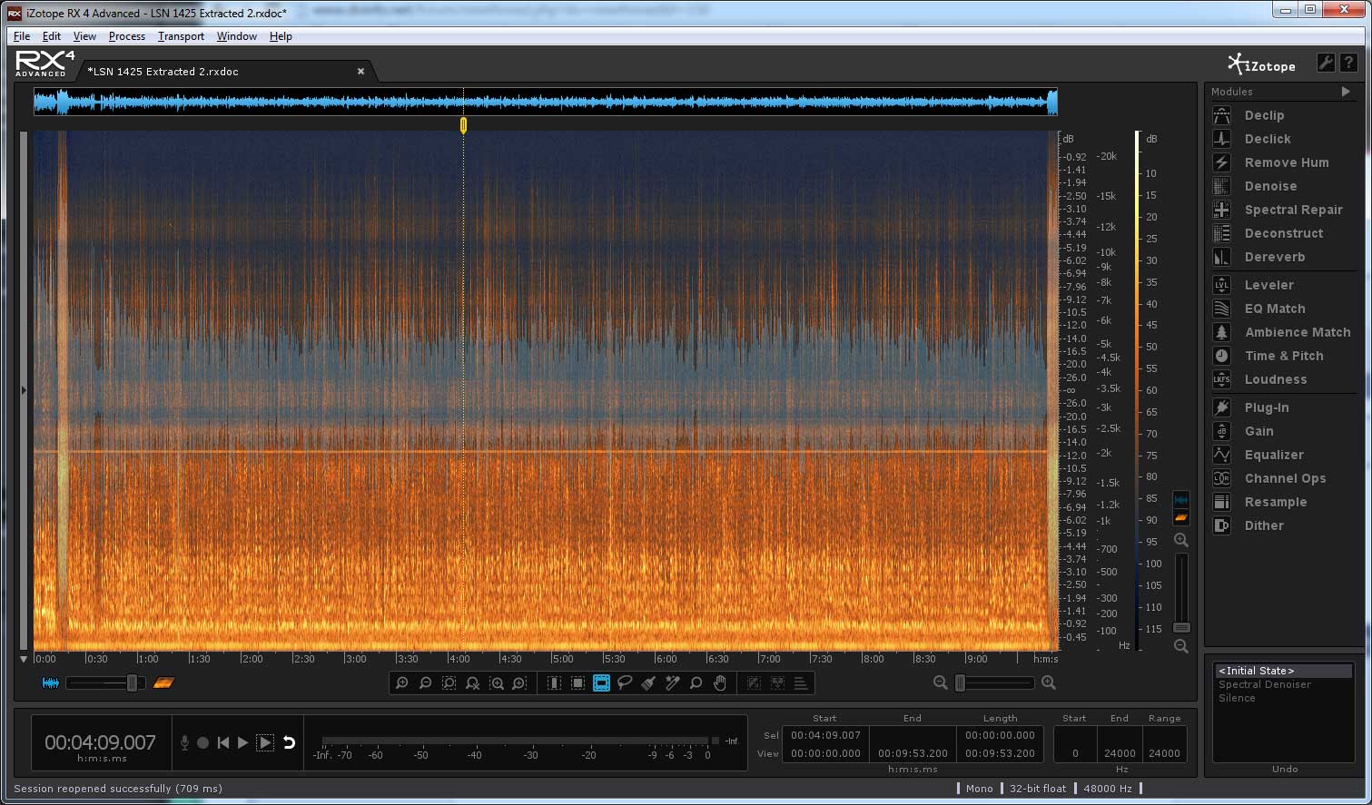

With the inclusion of internal mics built in to the camera, this has saved me from taking along extra mics and cables for atmosphere/crowd audio when shooting events. However, lately, I have been noticing an unwanted interference that has been in the audio tracks 3 and 4 that these internal mics record to.
The attached audio sample visual clearly shows the noise that is present at the 2k frequency.
The .wav audio file attached has a sample of this with the noise, and the 'after' where it (and some background rumble) has been cleaned out with izotope RX4. Yes, it's an easy fix but I shouldn't have to do it on audio from a $10k camera.
I was originally thinking that this could have been noise presented on the electrical circut that the camera was plugged in to when powered by the adapter brick, but this latest recording from last night was done running off battery only.
I'm inclined to think that it might be the noise from the fan from inside the camera. Any thoughts?

I have one of the mic inputs always left with phantom on as I mostly always have a NTG2 plugged on to it. In this recording it wasn't being used, but I have one from Saturday where it's plugged in and the same interference is still present in lines 3 and 4 from the internal mics..
Also, I have recordings where you can see the noise (in a spectral view in Izotope RX4 etc) start from a slightly lower frequency to where it sits ... much like the view of the electrical interference from an electrical motor if you've ever had that happen. (a rising curve in the frequency before it continues along on a flat line) This is why I am suspecting that it could be the internal fan when it kicks in and comes up to speed.
The camera was about 10 metres away (or less) and I was using a lapel mic to get speaker audio (into channel 1). The internal mics were for 'crowd mic' use only, and are probably on auto-grain by default..

Yes, the internal stereo mics on the PMW-300 are ONLY auto gain. This means they will pump up the noise floor if they think it's a quiet environment. (I'm sure you know this - just clarifying for anyone who might not know or have a PMW-300)

Firstly an update with the response from the Aust-NZ Sony tech support people (who, by the way, tell me that the camera model doesn't generate any service call thus far ... very reliable model).
There are two possible solutions to this issue.
The first is the fan control setting under OTHERS in the menu.
The default is “Auto”, but the other option is “Off in Rec” (Record).
I would advise setting to “Off in Rec” when the internal mics are used.
(image of related text from manual)
Of course all fans make some noise, it is inevitable, and the internal mics are very sensitive. Also if mic control is set to Auto then the mic AGC will increase when the ambient sound level is low thus exacerbating the background fan noise.
The alternative is to use an external directional mic via the external XLR input(s).
This has two advantages, a) the mic is somewhat mechanically isolated from the camera, and b) the mic being directional will minimise pickup from within the camera.
I'm still in two minds about the camera shipping with this issue still present. After all, what is the point of having the internal mics in the camera if you don't get a professionally acceptable recording quality in the 'native' mode of how the camera is set to operate? Also, from what I have seen the level of ambient noise makes no difference to the level of the unwanted fan noise.
The attraction to me for these internal mics is that it saves me from lugging in a audience mic (plus lead and a comparatively PITA mic stand) every time I record an event. The quality of the in-built mics is brilliant, and it gives me an appropriately stereo recording source for the ambience / audience.
I've since changed the "fan control" setting to "Off in rec." which as you can guess keeps it off when the camera is in recording mode. Under this setting, the fan will only automatically come on whilst recording if an excessive temperature is reached ... in which case you want it to come on.
The only thing you lose in having the fan in this mode is a theoretical shortening of the life span of electronic components from the camera internals being allowed to get to a higher temperature during operation. On a practical level, I'm not sure that we would ever notice this downside.
