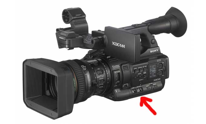

I certainly use auto white balance at times, depending on the circumstances. You should be able to use one of your white balance selection switches on the camera instead of an assignable button.
Andrew

The switch at the bottom should have three selection points, one for ATW and the other two for presets that you can set when doing a manual white balance (such as one for outdoors/sunlight and one for indoors/incandescent). The only button I push to set white balance is the one on the front face of the camera which then causes the camera to perform a white balance.
If you have the camera in ATW mode via that switch at the bottom, then it will continue to automatically adjust the white balance. There will always be a set delay before it decides that the lighting conditions really have changed (not just a momentary flash of a different light) and therefore adjusts the white balance / colour temperature that the camera is using. I've never adjusted that setting, having always used the default that the camera came with. (I have a PMW-300 K1)
