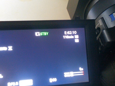

Out on a shoot today and after shooting some test clips the camera threw an E62:10 error.
I did a reset (Initialize I think in the menu). Error message was still there.
Noticed I could adjust focus.
Contacted Sony Tech Support and the said E62:10 is lens block impacting Focus and Stabilization.
I guess I'll send the camera off to Teaneck NJ and see what the estimate is.
This camera was well taken care of too.
BTW the ultimate sucky thing is I bought it early August 2015 with American Express which extends the manufacturers warranty by one year. So it's only about 8 weeks past the warranty period.

Christopher, Donald, I began thinking that the angle of restart might depend on which direction it was thrown out of alignment.
I flipped the camera upside down (handle side on the table) and turned it out. Low and behold, error message is gone.
Thanks for inspiring the thought.
So it isn't necessarily 90° but the angle needed probably is related to the angle out of alignment. So I'd revise that to try different angles. In my case upside down worked.
