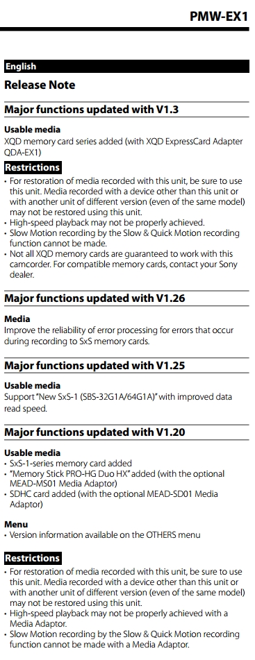

Here is a tech sheet on what the EX1 firmware versions have supported. Firmware 1.30 being the last that Sony released for the EX series.
As Leslie says v1.30 will run 64GB cards with no dramas whatsoever. That's also my experience with v1.3 on the EX3 as well. I have also heard the word put about that you can use up to 128GB SD cards.
Additionally the QDA-EX1 SxS to XQD card adapter can also be used to run XQD cards although I believe 64GB is the max in XQD.
Beware! If you have to upgrade to v1.3 (VersionUpTool_PMW-EX1_1.3) make sure to follow all the directions 100% to the letter..
YOU MUST USE THE HIDDEN SERVICE USB PORT. Not the one adjacent to the component port. The wrong USB port will brick the camera by all accounts.
Additionally there is a lens firmware upgrade for the EX1 called PMW_EX1_Lens0027_0102
