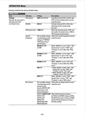

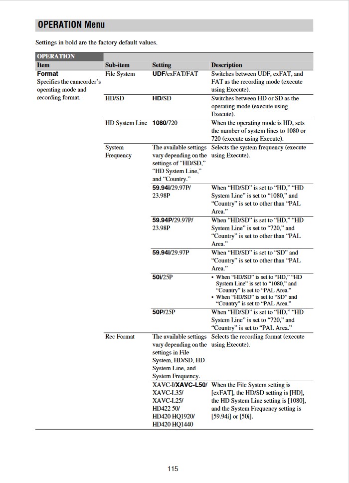

That's incorrect. The PMW-320 does support the QDA-EX1 adapters. Just make sure you are running the latest firmware "PMW-320 : SxS Binary Package V1.41" which can be downloaded from here:
https://pro.sony/en_GB/support-resou...-320k/software
Also if you want to run the XQD cards and the XAVC CODEC make sure the following settings are changed. With the format change from XDCam MPEG2 to XAVC-I or XAVC-L the cards will have to be reformatted as the MPEG codec requires the cards to be formatted as UDF whereas XAVC requires the cards to be formatted as exFAT. See the following page extracts from the manual for those settings which can be found under OPERATION/FILE SYSTEM.
Good luck squire!
Chris Young
Realistic card options with the PXW-Z280?-320-settings-pg115.jpg   Realistic card options with the PXW-Z280?-320-settings-pg61.jpg

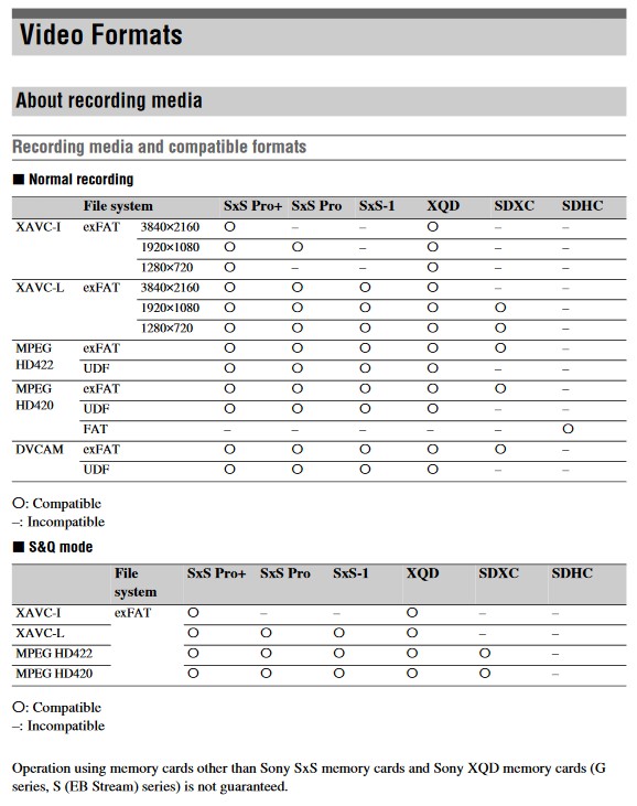

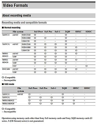

Seriously if you are working in daily HD broadcast situations just use XAVC-L. That's all I use in 95% of cases for broadcast. Miles more space on the cards. You can use much lower-rated cards and as Doug has said in the past visually for 99.9% of most material you won't see the difference. The only time I use XAVC-I is if I know there has to be a heavy grade done to the material or if I have some heavy-duty Green/Blue screen work to do. Most of my XAVC-I use is not for live broadcast. I use this XAVC-L workflow on any of the Sony cameras that offer me XAVC-L in probably 98% of situations.
IMHO so many people get carried away with the "If it's bigger it's got to be better" syndrome. Do you remember the groundbreaking "Top Gear" motoring show done by the BBC? That was all originally shot on XDCam 50mbps 8-bit 4:2:2 1080i which used the old MPEG-2 codec and it looked great. How the image is handled and presented is more important than sheer bitrate. I shoot live sports every week for broadcast and all our recordings are XAVC-L progressive and nobody says anything about the quality other than "Great pictures."
Check your Z280 manual page #137 for a list of formats and codecs you can shoot with. If it's only HD you need you can even use XAVC-L with SDXC cards formatted to exFAT. You would need either the MEAD-SD02 SDHC/SDXC Card Adapters from Sony or one of the other off-brand adapters for those SDXC cards. With the older SxS-1 cards you can shoot all the codecs bar the XAVC-I ones.
EDIT:
BTW. I had a look at those US$81.00 QDA-EX1 adapters selling on Ali Express and as far as I can tell they look identical to the genuine Sony ones I have. The" genuine" ones are also made in good old downtown China. A couple of those and some XQD cards and I would say you are on your way as the XQD cards will handle all the codecs the Z280 can throw at it using those QDA-EX1 adapters, as indicated on page #137 of the manual. That's exactly what I'm doing. Using XQD cards interchangeably between my XQD and SxS cameras.
https://www.bhphotovideo.com/c/product/978782-REG/sony_mead_sd02_sdhc_sdxc_card_adaptor.html/overview/BI/2855/KBID/3801
Chris Young
