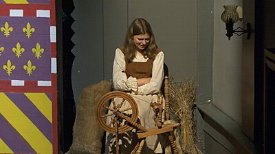

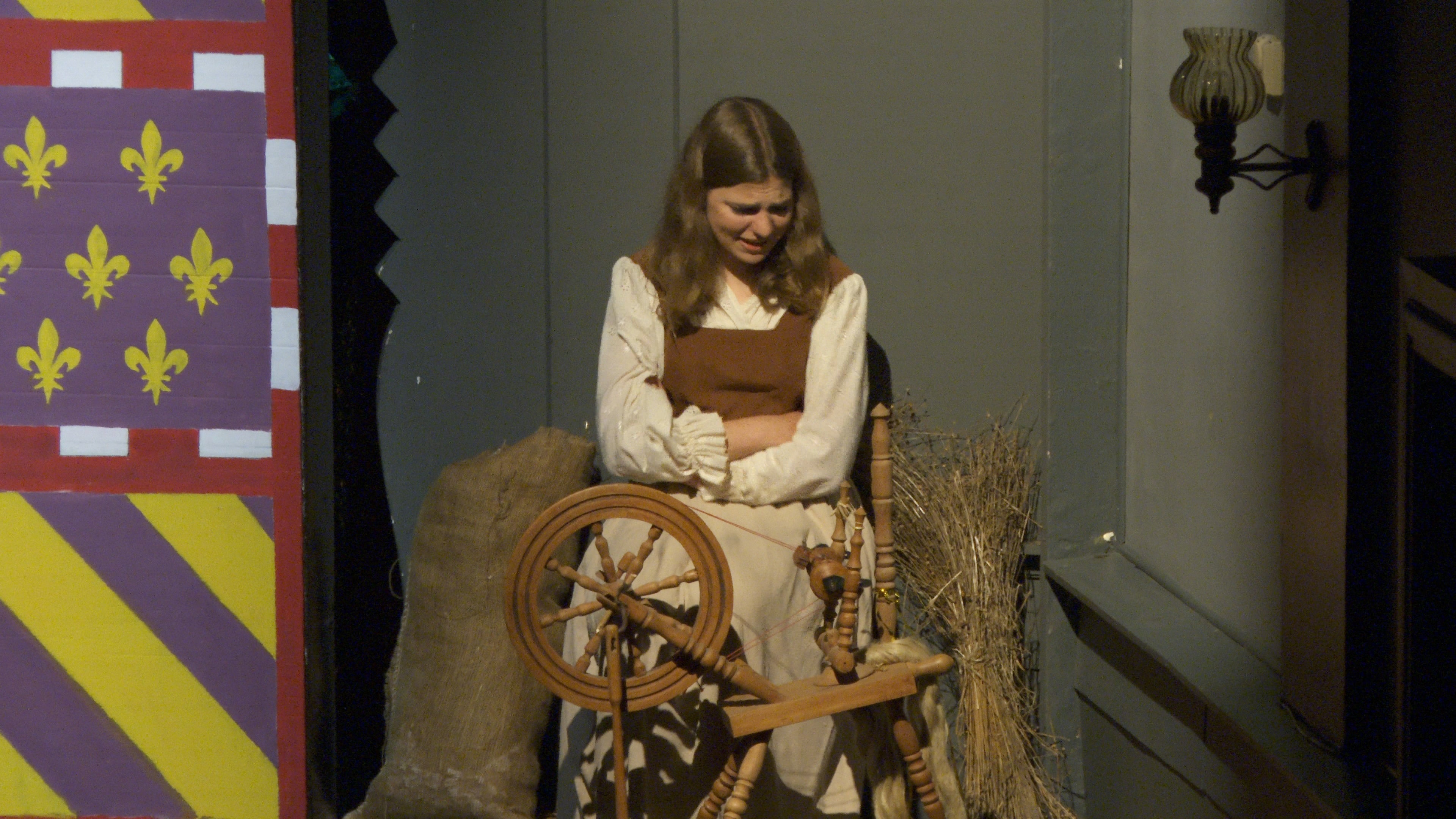

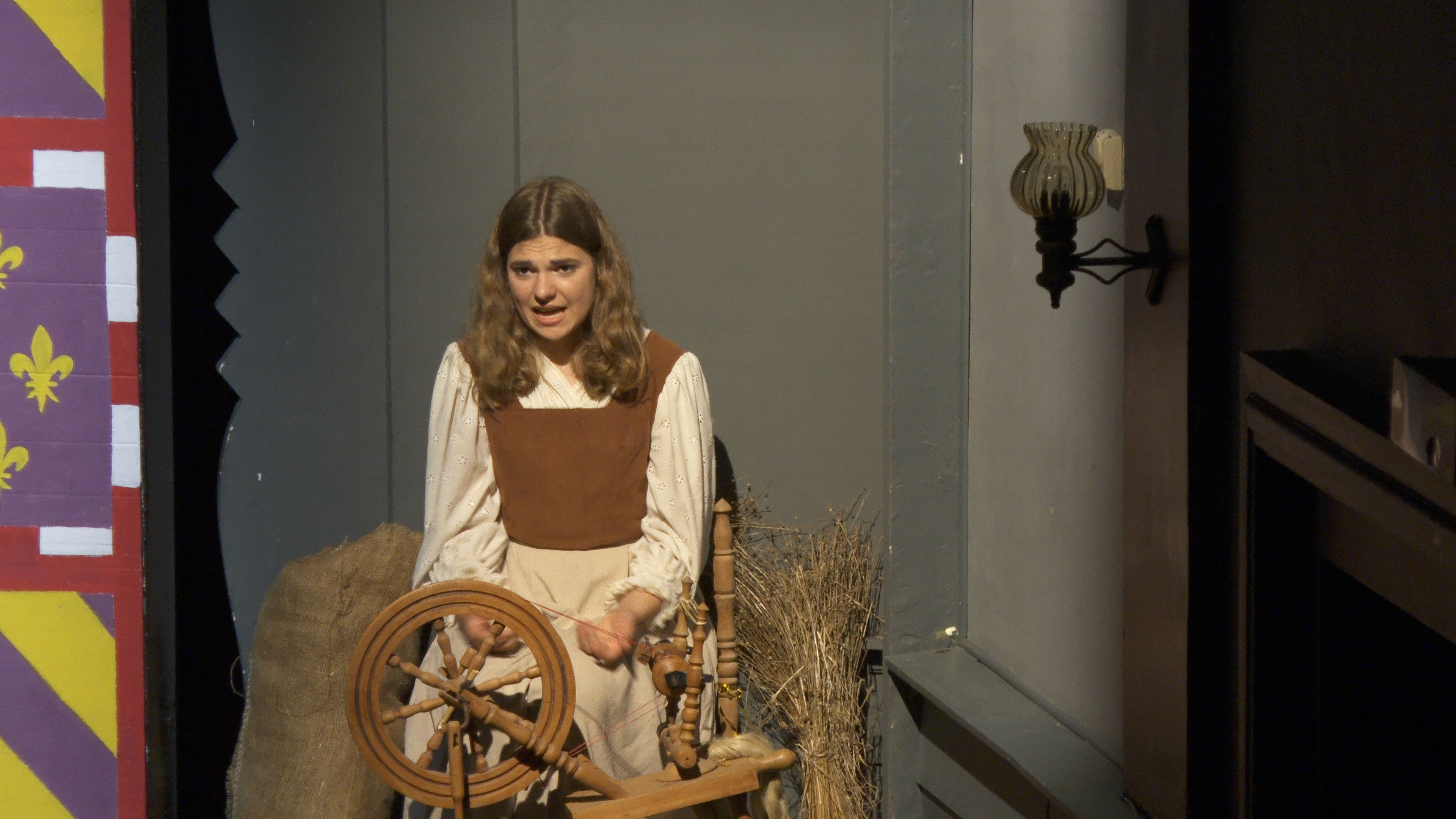

finishing this project. hard time color matching these 2 camcorders.
It seems to me that using the variable nd filter inside has some color cast and makes the footage less sharp?
I attached 2 samples with before the nd and after the nd.
I was reading this online: On the other hand, with variable ND filters, the image and the colors suffer as we change their intensity. this is about the sony variable nd.
matching Z280 and FX6-after-nd-filter-min.jpg   matching Z280 and FX6-zonder-nd-filter-min.jpg

Tom, I'd be willing to take a closer look and offer you my forensic opinion. But I can only do that if you upload two matching 20 second MXF clips from both cameras. Hopefully you know how to extract 20 short segments using Catalyst Browse. If you do it right, the copies will be identical to the full-length clips in every way (except shorter) with all metadata and image quality intact. It is absolutely essential for anyone judging the clips to be looking at originals that have been downloaded, rather than some JPG stills posted on a forum.
If you don't want to, that is fine. But I'm making the offer.

hi Doug, thx for the help you are offering again.
But this 2 screenshots are both from the Z280 (not from me FX6) Sorry for the confusing.
I saw while editing I switched quickly on the nd on the z280 in this scene (the fx6 was unattended and without nd filter and I had no acces to it when the stage show started)
Now I saw (I tell myself) that the nd filter shows color shift and less sharpness in this scene.

Sorry Tom, you were clear about both shots being from the same camera. I muddle my reply.
My offer still stands, however. Send me the two clips from the Z280 and I'll give you my evaluation of them, and try to pinpoint why they are different.
You should never see any difference in image quality with the variable ND. Let's take a closer look.
