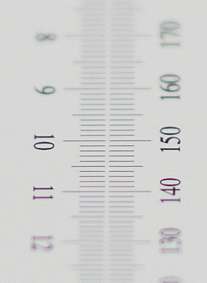

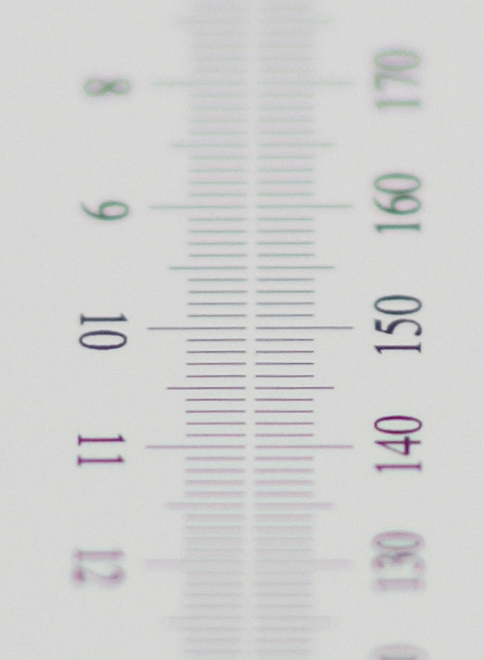

Lo-CA is different because it rears its ugly head more and more as the aperture gets wider which is why the f1.4 & f1.8 lenses have the biggest problem with Lo-CA. Furthermore, as the aperture gets wider, the MTF decreases while the Lo-CA increases.
Image below is from Zeiss ZA Planar T* 85mm f/1.4 ( Sony SAL-85F14Z ) - Review / Test Report - Analysis
Testing the Sony/Zeiss 85/1.4 on an A700. Notice the purple fringing on the lower numbers and the green fringe on the numbers above the focus plane. That is Longitudinal CA.
Just so people know that other Zeiss lenses have this issue, I have included the Nikon/Zeiss 85/1.4 from the same site Zeiss Planar ZF T* 85mm f/1.4 - Review / Test Report - Analysis
If people want the very best Zeiss SLR lenses for the F3, then get the Sony's: 24/2; 16-35/2.8; 24-70/2.8; 85/1.4; 135/1.8; for a budget zoom, the 16-80/3.5-4.5. And you can't go wrong with the Sony 'G' 70-200/2.8 and the Sony 'STF' 135/2.8(T4.5).

Lo CA is CA and the cause is the same as any other CA. The problem gets worse as you open the iris because the amount of glass being used increases and as a result so does the amount of dispersion, or to be precise variation in dispersion across each lens element as dispersion is dependant on glass thickness and this varies across the width of a lens. It's why for very large focal length, big aperture lenses, ie telescopes, mirrors are preferred as these don't suffer from CA.
