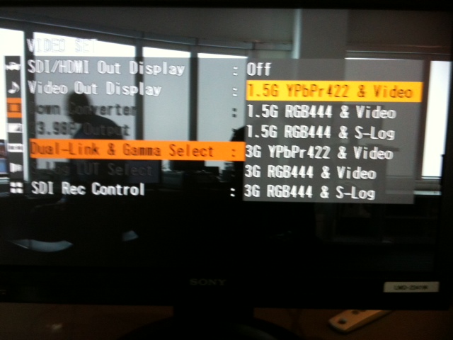

Just came from the Sony SR memory event in Toronto. There is an update on the firmware that allows both HDMI and SDI at the same time. Actually, it also gives you an option to separate the dual link and have a clean 1.5G to record to a Nano, the main SDI that you can have TC in etc from the LCD, and the HDMI as well.
Nigel Akam is offline   Reply With Quote

That sounds like excellent news. Is that an official firmware? When will it be released?

I had a production version of the F3 for the last couple of days and it didn't have this firmware yet. I think its pretty new. So hopefully we will be able to get it soon
