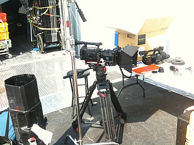

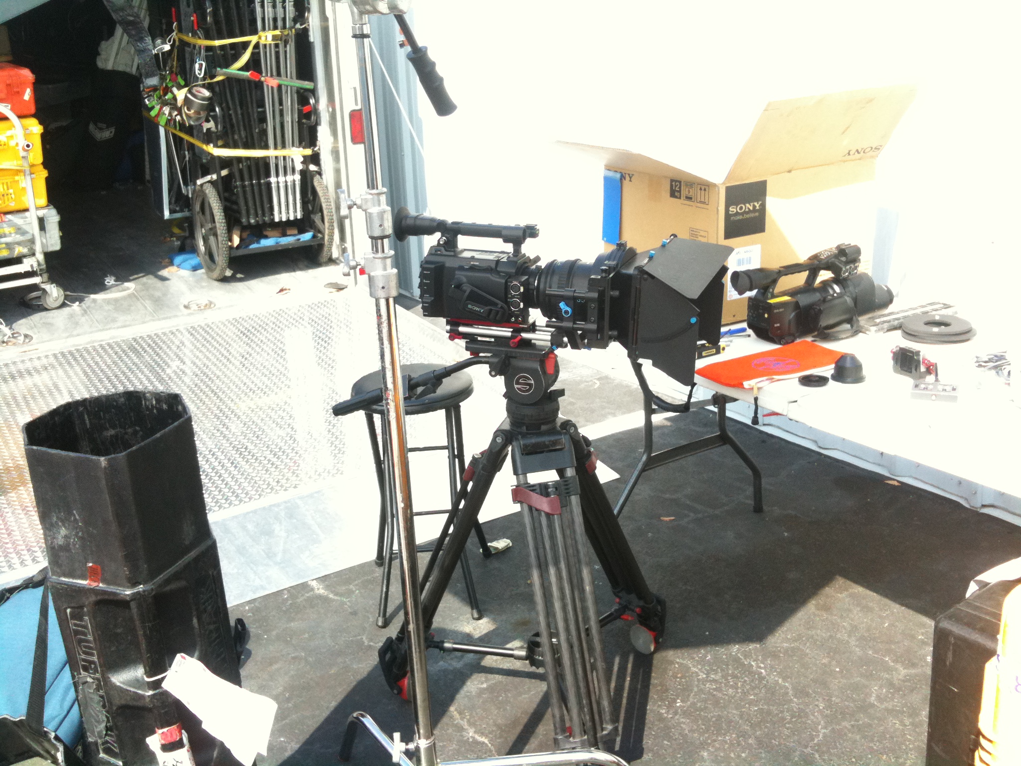

Ola,
Terrific compositions. My guess is this material is from the internal 35Mb SxS. Looks fantastic.
I just arrived in London with an F3 and the Sony prime kit 35/50/85. In addition we have an EX3 with a Letus(Probably the last time I use it) , a PDW-800 and a Canon 5D. My lens kit also includes Zeiss ZF 21/28/50/85/100. 4 Nano Flashes for off camera recording of the F3 and EX3.
Im here working, but testing at the same time.
I just got off the phone with Mike Tapa, and we will meet up to go over his adapter.
I can not tell you all how excited I am. It has been many years of P+S Pro 35(2/3) then Letus(EX 1/2) and then 5D. I can honestly say the 5D has produced many great images, but when it falls short of being a dedicated acquisition tool due to its many limitations, I look like a rookie. With the F3, all those limitations are for gone and for what this camera can do is far beyond REC 709 and 35Mb. I will be doing 10 bit off camera recording in S LOG as soon as Sony lets me. Real soon. I can not wait.
I put the rig together with a Zacuto plate and rails, Redrock Matte and FF, TV logic 7, and Nano. This camera has enough 1/4 20 to handle it all. I might combine two 1/4 20 on one mount for the Monitor. The BeBob CoCo power adapter I had from my EX1 will work with the F3 after a bit of plastic is cut from the adapter. Now I have two Hirose and one D tap. The FF slot needs to be filed out about an 1/8 so the Sony Lens can be removed and replaced with more ease. I will invest in a proper FF soon.
I will post ASAP on our experiences.

Wow! That sounds like a great kit. Good luck with your shoot. My guess is that you'll either strip the EX3 of it's adapter or put the whole contraption in a box once you start comparing adapter-images with the F3-image.
I will also try out a nano as soon as I can but I am a little afraid to. I am very happy with the EX-codec and for what I do (documentaries and current affairs) it does really well. I don't want to start drooling over an even better image and be forced to carry around yet another thing on my shoots.
Anyway - when it comes to the MTF-adapter I am very happy with the build quality and what it does. However I find it really hard to adjust the aperture. It is hard to reach the adaptor ring because of the width of the F3 and if you don't find the small stud on the adaptor by chance the adaptor ring is too slippery to get a good grip on. I'd like the ring to have a pattern to make it easier to grip and the stud to be much longer so it can be reached with a finger without having to reach around the front of the camera.
Looking forward in seeing what Mike will come up with. Hopefully there will be an upgrade plan for early adapters as well. :-)
