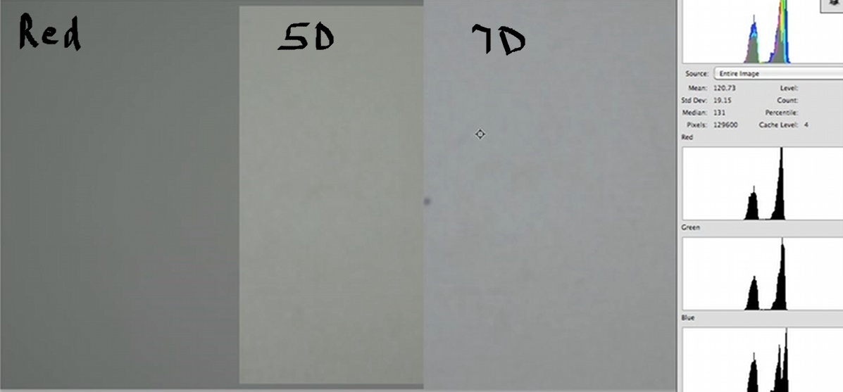

The price points differences between a $2K DSLR, a $25K RED and a $60K Alexa make comparing their merits and shortcomings a mood point.
Producers, Directors and DoP's need to know the difference so they CAN select the best tool for the job. The people making the choice on what tools are used must know the shortcomings of each tool, and the Canons have some serious issues.
For the color difference, each camera was white balanced; thus, theoretically speaking, there shouldn't be much of a difference. The Red's image had a Rec 709 LUT applied to match the Canons. The class also showed how much more noise is in the image between the first second of recording and 30mins later. In addition, he showed how Canon uses Auto Gain at certain ISO levels to reduce noise.
In the attached image, each camera was set to ISO 320, 1/50, F11 except the 5D was f13. This was shooting a 50% grey card. Another test showed how the 5D's metering can be way off from f1.2 to 5.6 to f16 with nothing else changing but the aperture.

Not being anally argumentative here, if this was a controlled experiment, then the lens and F stops used had to be identical. It wouldn't make sense for the RED to use a Zeiss ultra prime lens calibrated in T stops for true light transmission against the Canons using a cheap zoom kit lens, with different colored glasses, and calibrated in mathematical F stops, (not accounting for light loss from its glass elements).
And I wonder why the 5D used F13 instead of F11 for the other cameras? From the picture, the grey cards shot with both the Canons are overexposed against the RED's, so instead of the color shifts, there is also an exposure difference, or differences in sensors sensitivity. During my recent Alexa shoot, our data tech did remind me my 5D's signal was 1/3 stop hotter, observing both cameras through a Leader wave form monitor, so I had to stop the 5D down by one ISO increment to match the footage. I wonder if this was why they used F13 and F11 for the other cameras.
