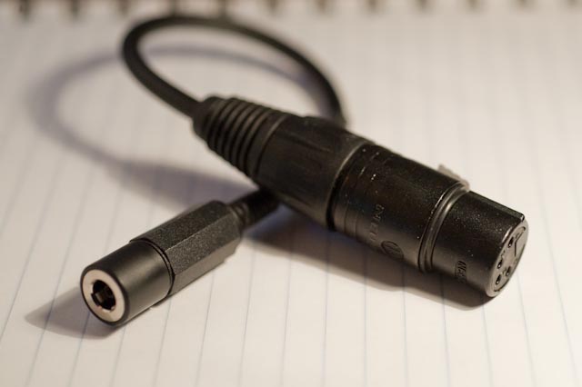

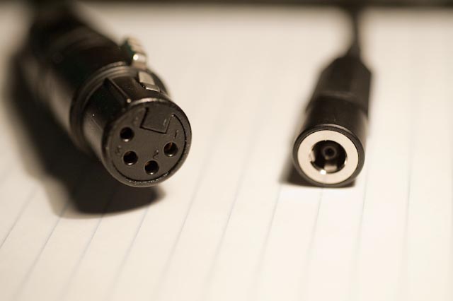

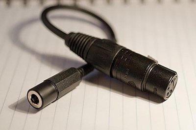

This is the adaptor cable I just received from convergent design that will allow me to power the Nanoflash off the Swit battery's D-tap and power the camera with the 4-pin.

From the picture you are going to plug the Swit pigtail into that cable and then plug it into the XLR 4-pin DC in of the F3. Then you will connect a D-Tap to Hirose cable from the Swit D-Tap connector and plug it into the Nano Flash to power it.
For an EX camera, you would not use that cable at all, but rather plug the pigtail into the camera DC in directly and use a D-Tap to Hirose for the Nano Flash.
I'm using a similar system for F3, but with 2 D-Taps and an Anton Bauer breakout for up to 4 D-Taps
http://www.bhphotovideo.com/c/product/204182-REG/Anton_Bauer_POWERTAP_MULTI_PowerTap_Multi.html
But I like the cable shown here, so I guess I'll be giving Dan a call next week . . .
