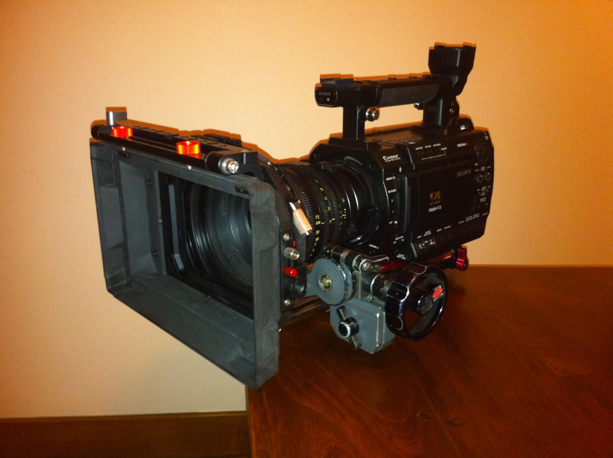

Just bought an O'connor Obox and am very impressed. About 80-90% as refined as an Arriflex MMB-1, at 60% of the price.
Way more sturdy than Arri, believe it or not. By far the most rigid, tough mattebox I've ever used/seen (and I've used the big daddy modern cast Arris like the MB-14), it's in it's own category as far as that part is concerned. And very light. Picture below is making it look bigger than it is (wide angle on iPhone). It's not that big at all.
Between the Redrock and Obox, there is not much comparison, even though they are in the same price bracket. I had the Redrock, it got me through but it kept wanting to loosen up and drop pieces. Sold it 9 months later when I had more to spend.
Just FYI, the guy designing all the new O'Connor camera accessories is the same guy who designed the same stuff at Arriflex for the last 8 or so years.
Mattbox/follow focus - suggestions please-photo-mar-30-7-47-06-pm.jpg
WHAT the bloody hell is that submarine dive module looking thing on the side of your camera! thats awesome!
Willytec, overkill king of follow focuses:
Cinematography.net discussion
I bought it for my Red kit, it's a little much for the F3. But I'm not going to sell it to go smaller, I'll just deal. It is amazing though, it does just about everything. In my pic above, I have just the simple handwheel on. Have both regular marking disc handwheel and dual speed handwheels in my kit.
