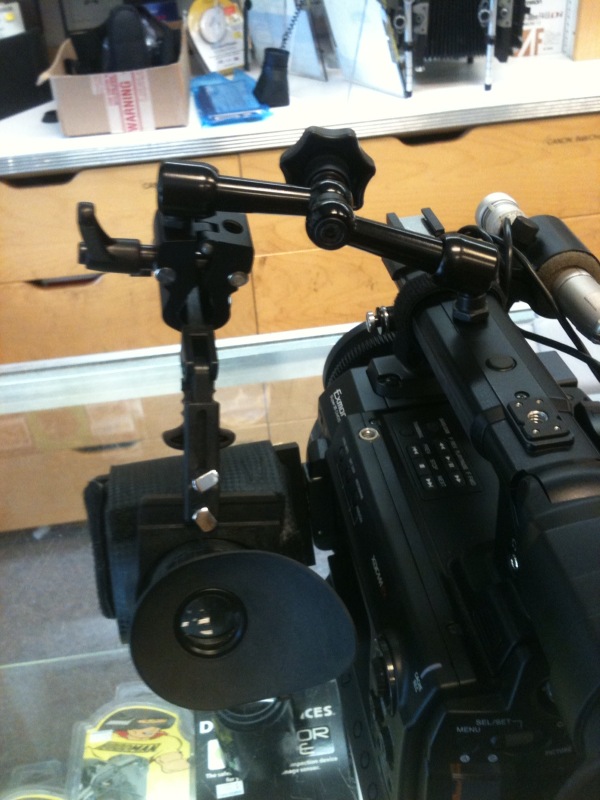

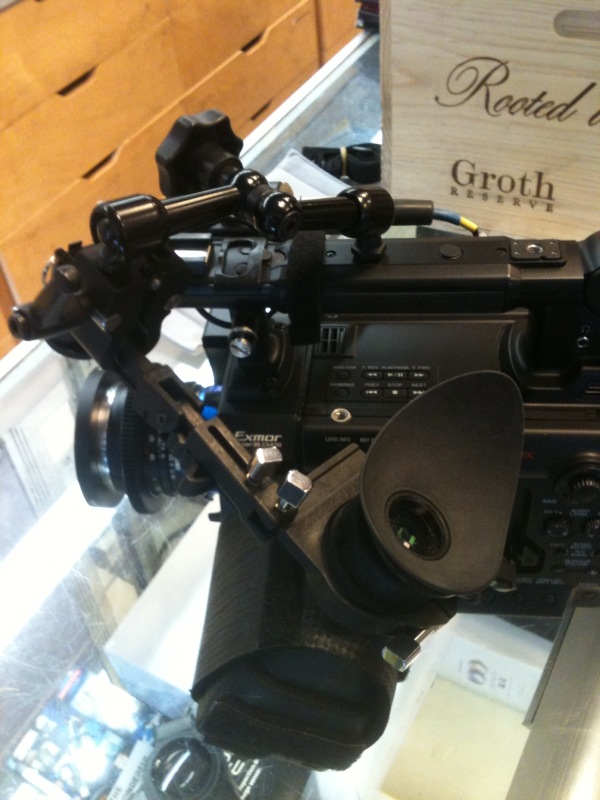

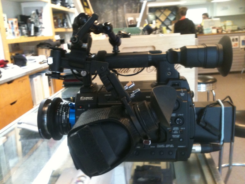

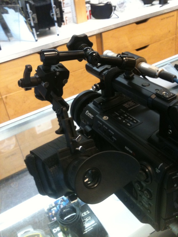

At my local camera store this afternoon I noticed a Hoodman crane and was hit with a way I could use it adapt my Hoodman EX-1 flip out screen viewer to the F3.
Of course the problem with the F3 has been that the Hoodman seems to be to heavy for the flimsy hinge that Sony in its wisdom has provided us with.

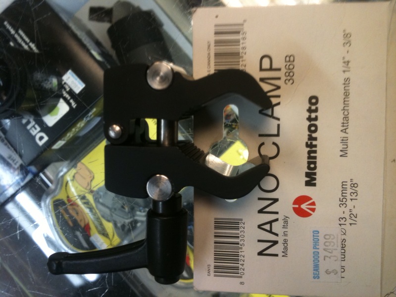

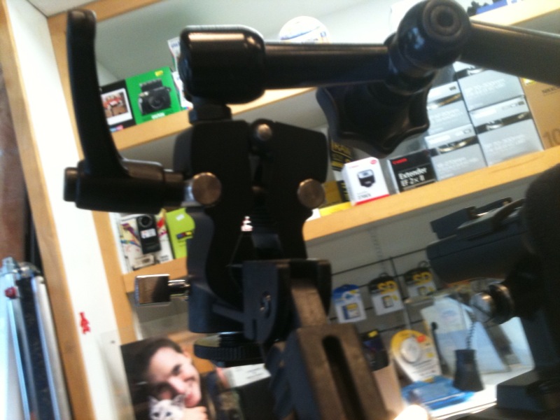

By using a 6" articulating arm I picked up at the Small HD website ($80) and a little Manfrotto clamp I found in the camera store ( Manf #386B $35) I was able to place the "HoodLoupe 3.0 "right above the flip out screen without adding any pressure to it. I still connected it with the velcro fabric that Hoodman provides but that was only for light proofing and keeping a solid connection, but all the weight was off the F3 screen.
I was quite surprised at how flexible it was if I wanted to change the angle of the screen as well for looking down or straight ahead.
This seemed like a better system than the one Sony was auditioning at NAB which looked very heavy to me and didn't allow you to close the door.
Unfortunately the visual quality still didn't knock me out though my guess is the limiting factor was the flip out screen not the Hoodman. Seemed to me around the same as the Zacuto or the Cineroid neither of which I liked. I seem to have a lot of trouble with the Zacuto viewer though as it never looks sharp to me. Your mileage may vary.
Actually I wish Sony offered a general peaking adjustment for that flip out independent of the color peaking. Also it would be cool to have a B/W option like they have for the rear viewfinder as well.
It might work better with a longer arm and maybe Hoodman will come up with a simpler system but meanwhile I think this works though I haven't had a chance to try it out in the real world yet.
