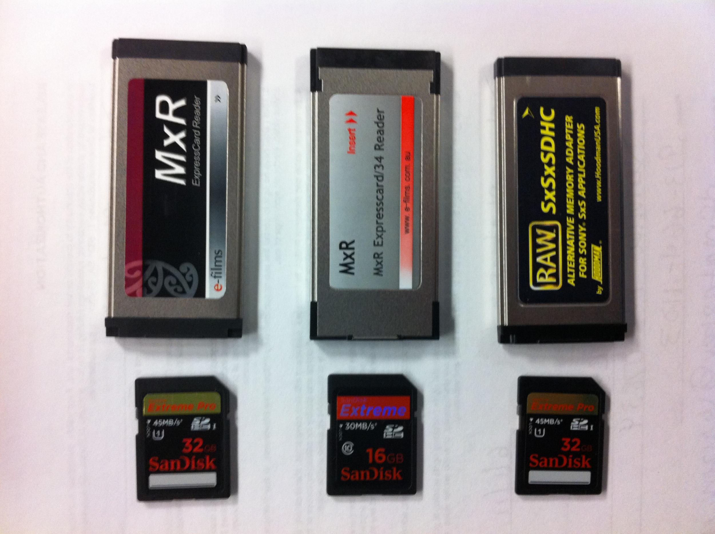

Just did the update and I can confirm the following cards (pictured here) work with the upgrade.
I did do the upgrade with a Sony SxS 8GB card with sucess.
Did not get the S&Q knob working with the menus, I thought this was the case with the 1.1 upgrade. What am I missing? Hold down the cancel button then press the down the S&Q button to enable the S&Q button. Repeat the above action to disable so that it is a S&Q button, one or the other. Thank you Doug Jensen for that!

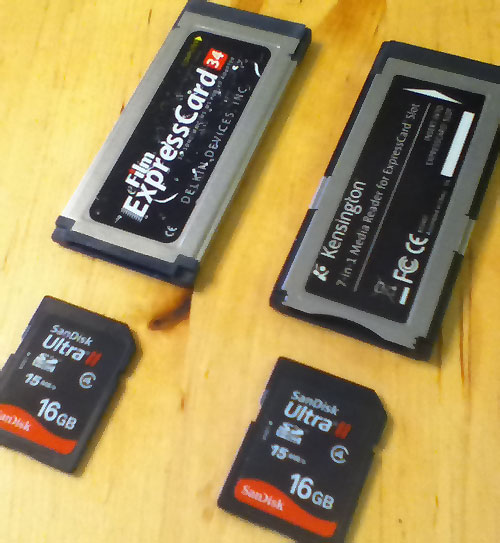

Banged off a couple of clips on my now ancient SDHC/adapter combos using the Delkin and Kensington adapters with Sandisk UltraII Class 4 16GB cards. They worked as per usual
