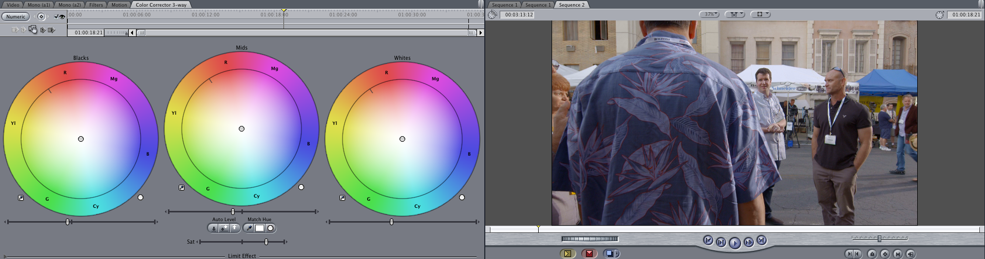

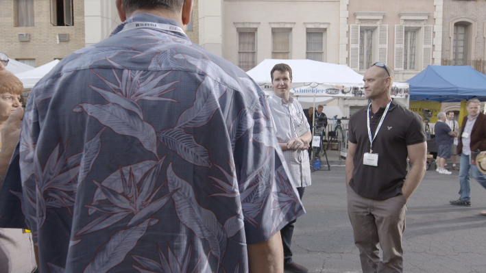

I shot some S-Log without a LUT to the SxS cards on a demo camera at Cinegear last Friday.
First is a grab of what it looks like out of the camera by itself. Second is a "non-correct" correction using the FCP 3-way corrector.
Somebody will argue that the correction is not exact, but I'm not sure what the point of an "exact" correction is, as the footage is likely going to have a real color pass using another method later anyway.
I suppose somebody will want a correct S-Log LUT applied in the timeline so they can go directly to broadcast without color-correction work, but at that point I have to ask, why did you shoot S-Log then in the first place? S-Log is for color work with good tools. Anything else should be an offline.
