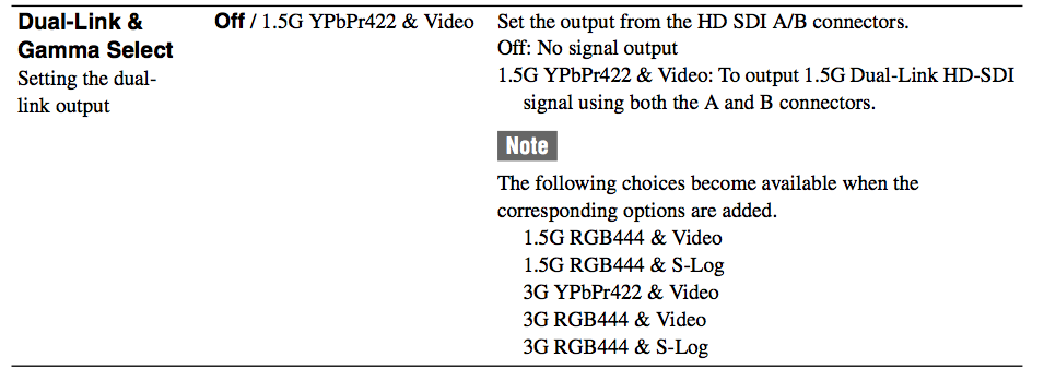

Old September 5th, 2011, 10:05 AM   #4
Location: Hobe Sound, Florida
Posts: 213
Re: S-Log question
The Log settings are for 444. you can get 422 S Log from the SDI by turning off the LUT
