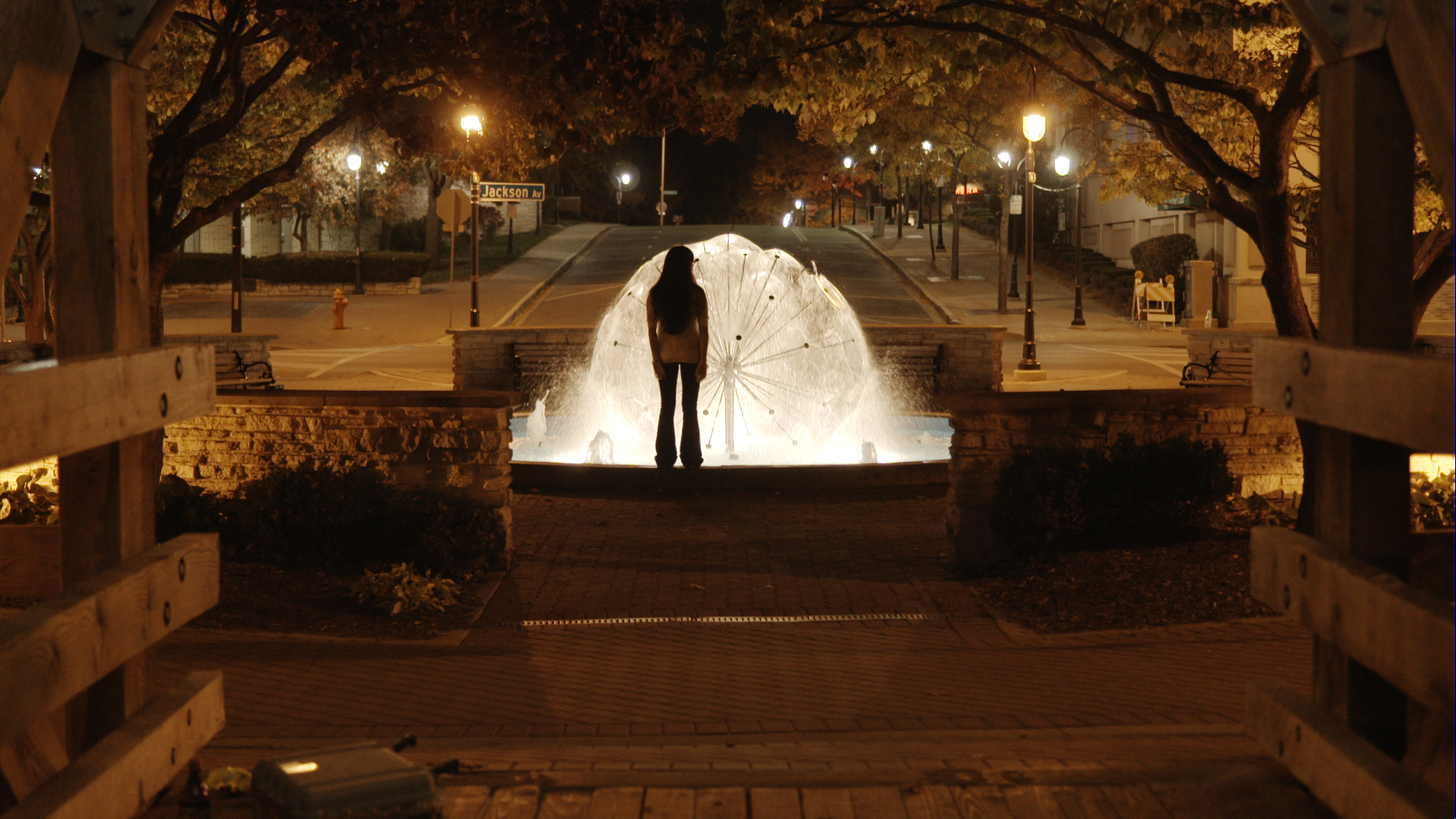

Can you guess what settings this was shot at?
S-Log, +12DB and Sony 35mm T2.0 - which means ISO 6400. Oh yeah, and it was recorded to a PIX240 at 1080 30p with PR HQ (220Mb/s).
I included a jpeg before and after a simple curve in Photoshop and a TIFF for an uncompressed view.
I don't see any need to use NV with an F3. It is just amazing at how little noise there is. At ISO 6400, this camera is cleaner than my EX3 even with its PP set to reduce noise.
Are you using the new version of NV which includes CUDA acceleration? If so, is it noticeably faster?
F3 + S-Log + -3dB + Neat Video = SUPER CLEAN!-pix_001_109.tif   F3 + S-Log + -3dB + Neat Video = SUPER CLEAN!-pix_001_109_grade.jpg

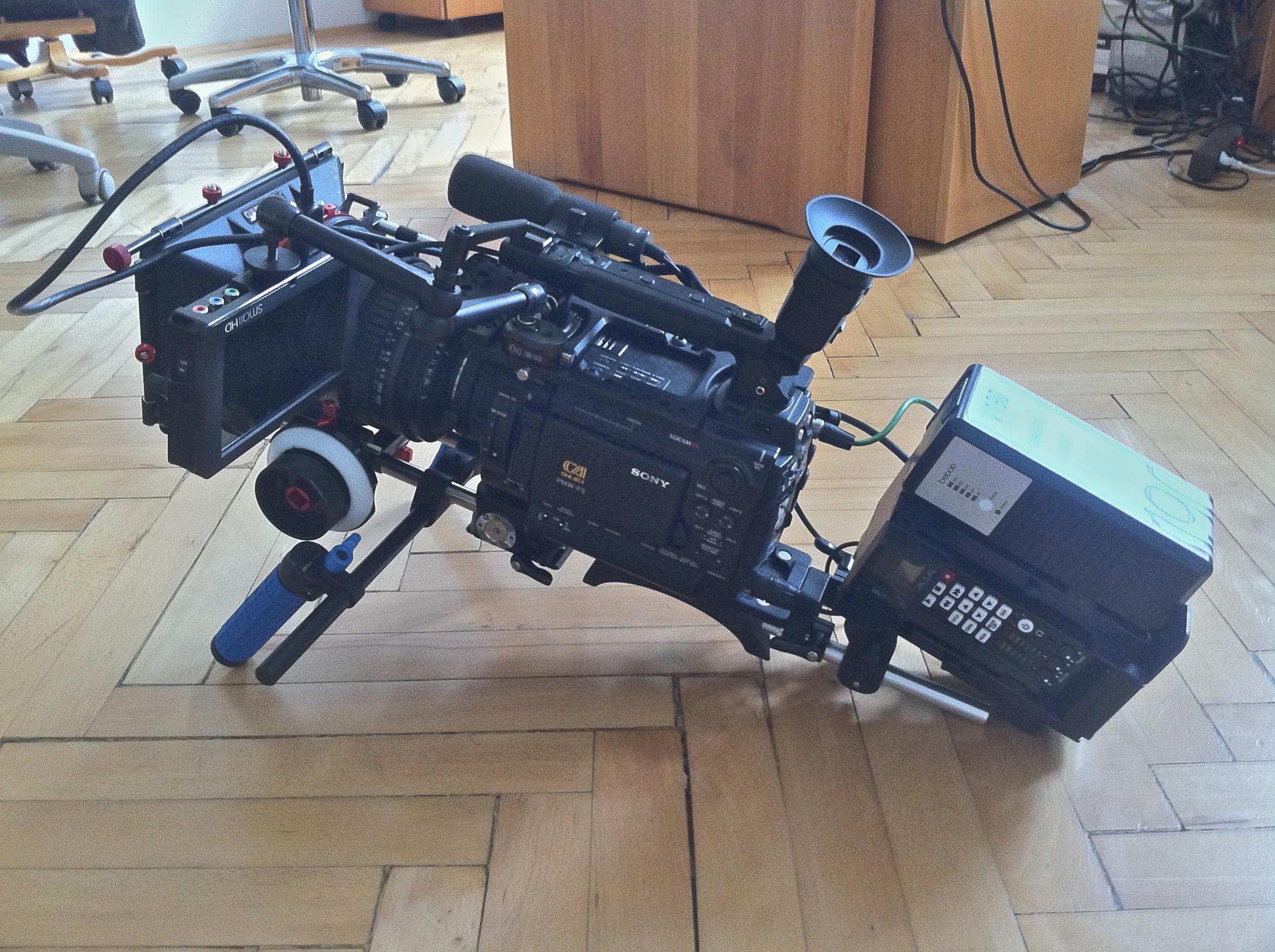

Btw, the attached image is/was my setup.

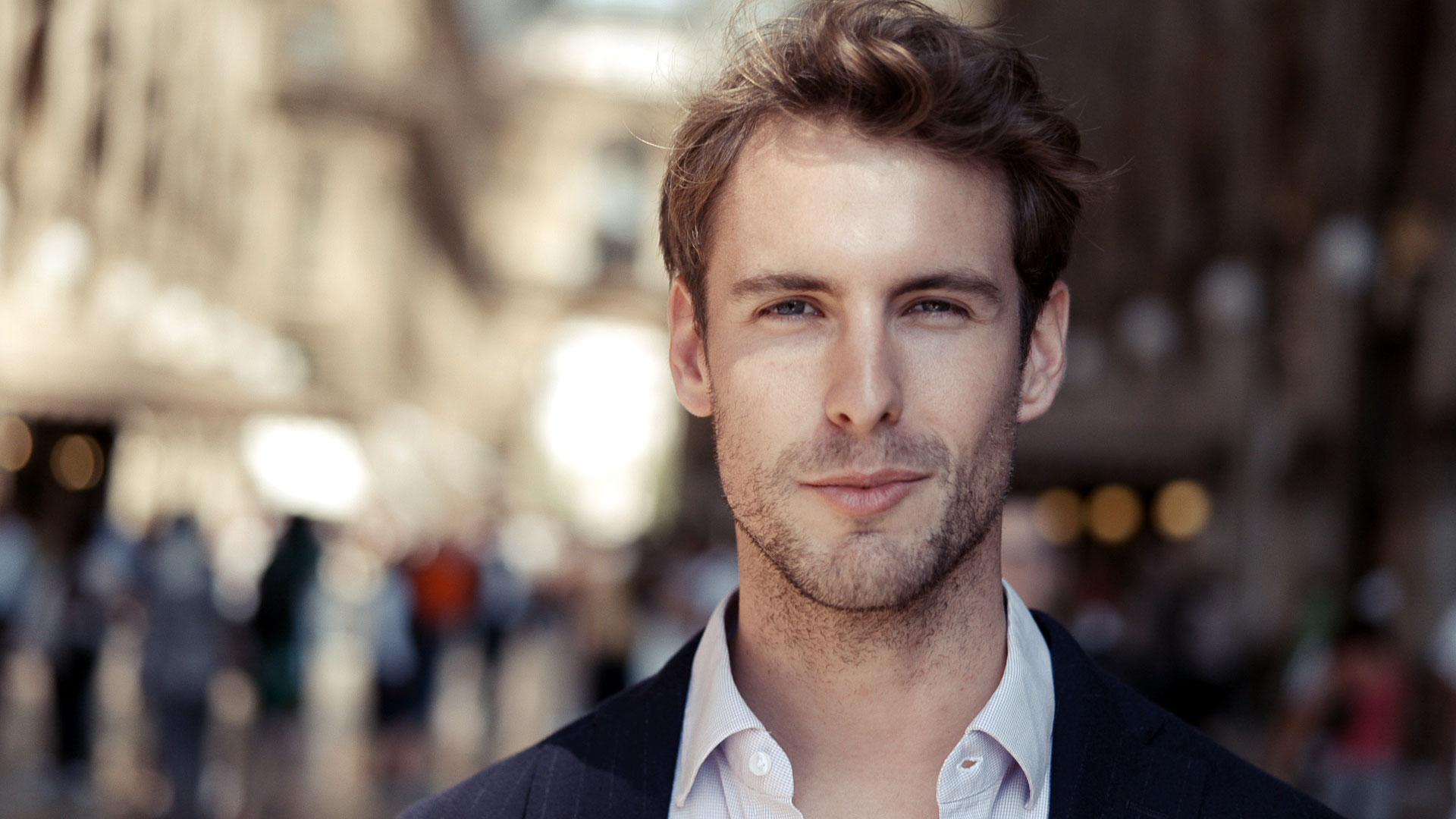

Here is screenshot of the F3 output. Simply amazing!
