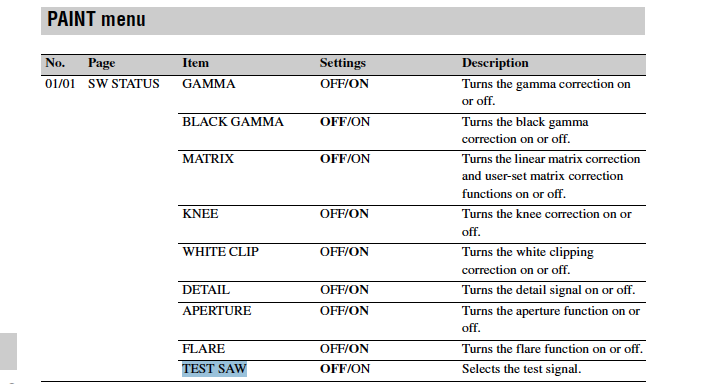

Location: Hobe Sound, Florida
Posts: 213
Re: S-Log Exposure Discussion
Hornady,
I do not believe a Test Saw option is on the F3.
On the 800 it is in the Paint Menu
Dennis Dillon is offline   Reply With Quote

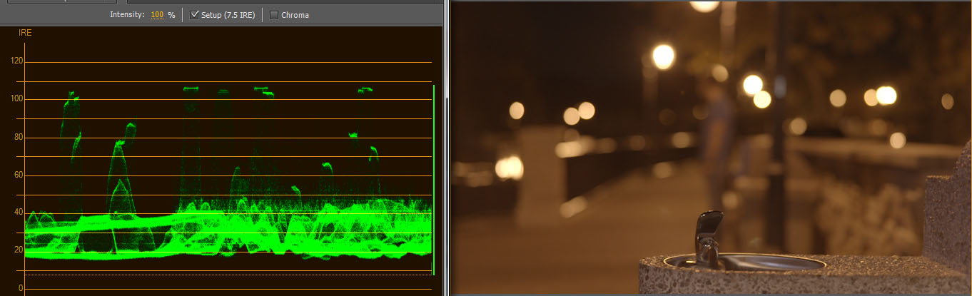

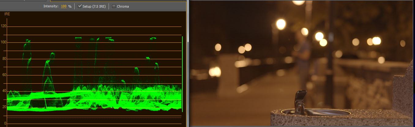

I just checked some footage and I don't see anything different between XDCAM EX and Pro Res in Premiere Pro CS5. (recorded to a PIX240 at 0 or 6db).
XDCAM on left and Pro Res on right.
S-Log Exposure Discussion-s-log_xdcam_ex.jpg   S-Log Exposure Discussion-s-log_s-log.jpg
