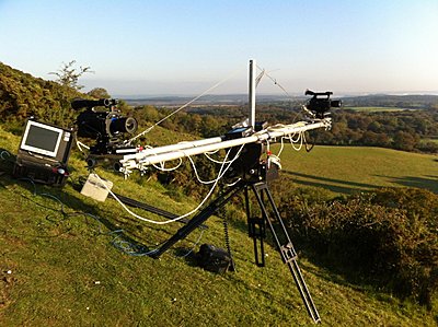

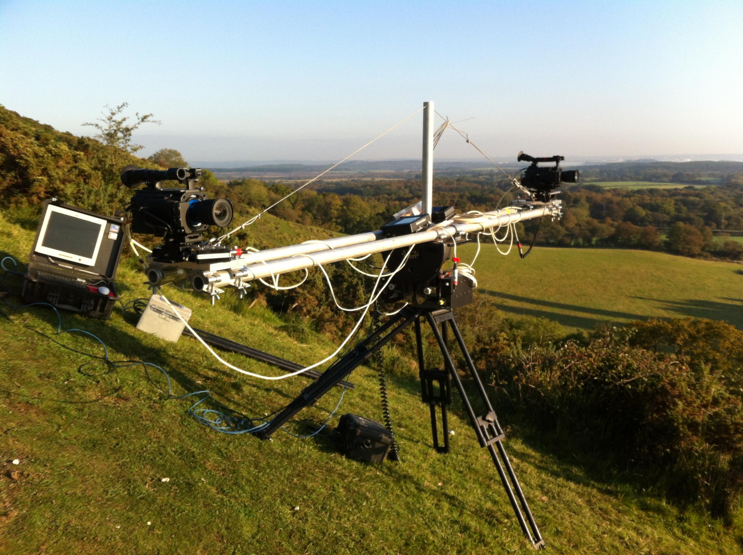

Thanks for the kind words. It's a teaser for part of a much larger project that we should start shooting in the new year. It looks even more incredible in 3D. It's a shame about all the banding that results from a combination of high compression ratio, very gentle sky graduation and 6 bit computer screens. The original looks really nice on a decent monitor.
I've attached a couple of pictures of the rig.

Wow, that's quite some interocular distance on the 3D rig!
Paul Ream is offline   Reply With Quote
Old November 11th, 2011, 12:05 PM   #6
Posts: 4,957
Re: Dawn at Corfe Castle. F3 and Motion Control
Yes, 4m interoccular. The main shoot will be even wider, were building a special mount and motorised head system.
