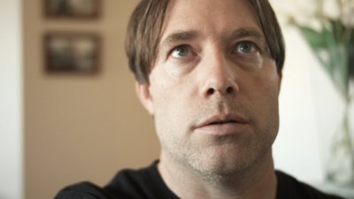

Further to my initial post, the quality of the images from the Pix 240 are incredible. That, along with S-Log would have to be the optimum accessories for the F3, I reckon. Perhaps you might invest in an external Sony dedicated recorder if you were using an F35 or F65, for example. But to spend $8000-$10,000 on a Gemini or Cinedeck recorder to capture images from a $16,000 camera just doesn't seem to justify.
The images below are difficult to tell apart, but both were recorded at near the same time on SxS card and Pix 240. They are both ungraded S-Log. You can however tell the difference when viewing through a large television.

You will see more of a diffrence in high details areas when the subject or camera moves. This is what I noticed on my Samurai.

True, and the same with the Pix 240, particularly when the camera moves. There's little blur. You can actually follow the detail as you're panning. I also like the fact that there's far less of the jagged lines you get with interlaced video.
