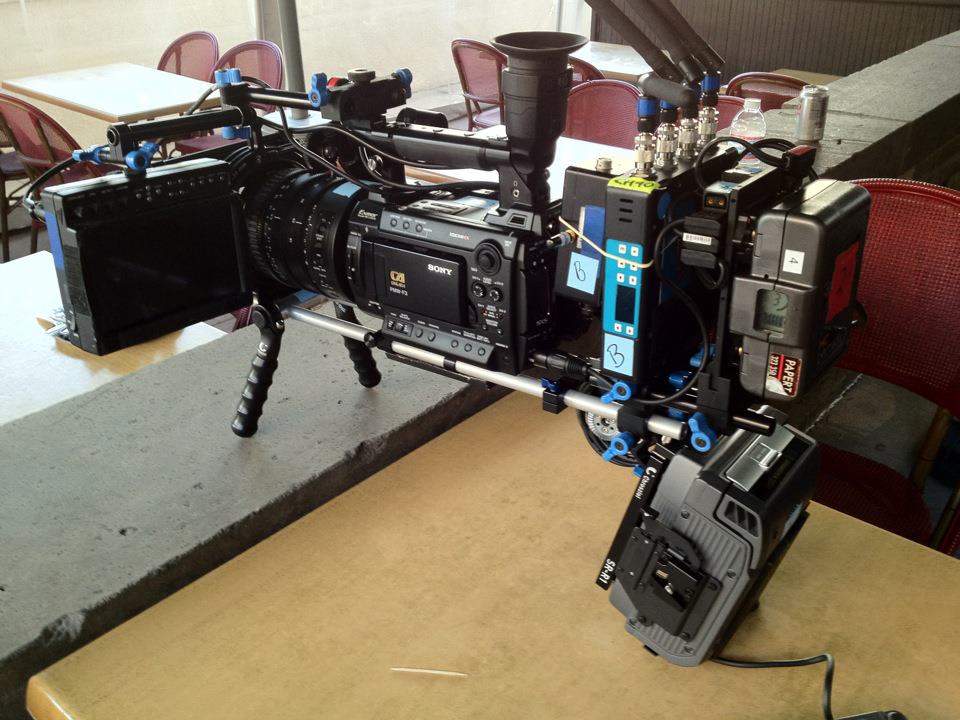

I just wrapped a spec pilot that shot on F3's and the newest addition to that product line, the SR-R1 recorder and the 14x lens.
First, the recorder. It's a hefty size; about the same size and weight as the camera itself, but with Chrosziel's solid bracket that allows rotation through 180 degrees, it neatly counterweights the camera turning it into a stable shoulder mount setup. As can be seen in the picture we had additional gear at the back (Preston remote focus, Boxx HD transmitter amongst other things) which tipped it into back-heavy territory, rather unusual for any camera these days. The Marshall was pressed into service when our outboard viewfinder went down unexpectedly which brought the weight forward again.

Any guess on the total weight as shown?

Dennis, we didn't put it on a scale but I would estimate 20-25 lbs. That to me represents a good amount of mass to deliver solid handheld work (for a run and gun, all day long situation, 5 lbs less would be worth the tradeoff in stability). Having the deck down low increased the axial stability of the setup substantially.

Could someone please tell me what are all the pieces attached to the camera? I can only make out the viewfinder, the follow focus (non visible) and what i assume is a mattebox.

From Front to back
Chrosziel Lightweight Mattebos (looks like a clip on- Barely visible)
New Sony lens.
Above the lens is an arm to hold the 7"(?) on board monitor
The Monitor (maybe a panasonic or a tvlogic can't tell.
Below the lens is handles for handheld setup.
The Camera
Behind the Camera is what appears to be a wireless broadcast system perhaps from a steadicam operator.
behind that is an anton bauer battery plate, with battery'
Underneath that is the new sony SRR1 "deck"
Charles can chime in and correct anything that I may be mistaken on.

Pretty much correct Nick, thanks for getting in there (I didn't get notified of Adrian's post, sorry).
The Chrosziel mattebox was rod-mounted. Their handles also.
Monitor is a Marshall 7". We had a SmallHD DP4 viewfinder but it developed an issue, since fixed.
Behind the camera is the receiver for the Preston single-channel remote lens control--this allowed the operators to move freely handheld without having the AC's hand on a whip or focus knob.
Behind that, the Boxx Meridien HD transmitter.
Rest is as Nick noted.

And then again, in your expert opinion, how bad is it that we don't have a mattebox? how different is that 7 inch monitor against the one in the camera (and against, say a sony 19'' plasma which is what we're actually using for reference)

The operators couldn't use the built in screen as it was too far back when they were operating with the camera handheld. The Marshall is really too large--the DP6 was a better choice (it was on the other camera) and for me, a viewfinder is even better, for handheld.
Remote lens controls are required for large-sensor remote camera work on Steadicam, and handy for jib and handheld work.Yes, they don't come cheap--expect at least $4K for a reputable single channel system, and a three channel (focus, iris, zoom) will run more than the cost of the camera itself.
