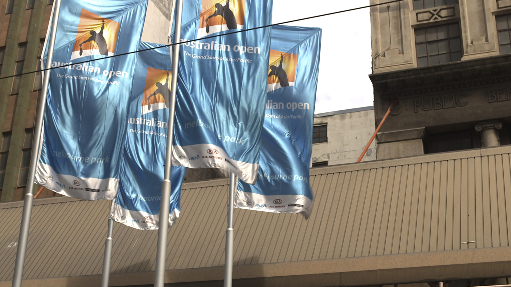

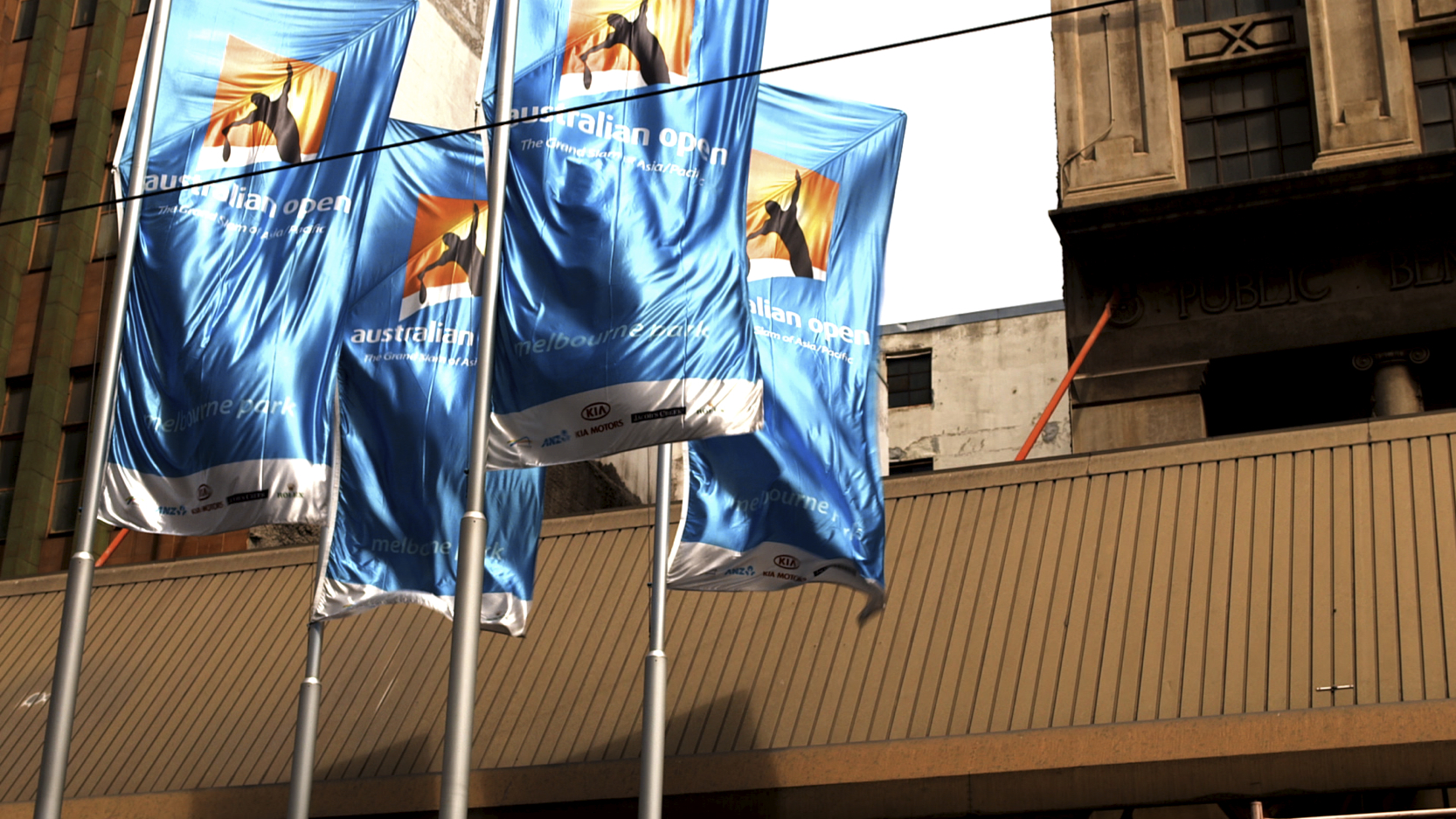

So, how is this?
Graded and ungraded material; original files with s-log.
http://www.dvinfo.net/forum/attachme...1&d=1328442622
Does S-Log need to be graded all the time?-ungraded.jpg   Does S-Log need to be graded all the time?-graded.jpg

Shame it's over exposed. The flag poles and sky are well into clipping, its not a good example of the way to use S-Log. The graded shots could have looked just the same if the exposure had been lower, but there would have been the option to avoid the clipped highlights if desired. The normal use of S-Log, generally speaking is to shoot with a lower mid grey point to increase the over exposure latitude, so you can then grade up in post.
Of course ultimately as DoP or Camera operator it's up to you how you choose to expose. But, I would shoot in a way that maximises what can be done in post (which normal means protecting highlights) so that the finished look can be fine tuned later. This does then tend to mean that some kind of grading will be required, but that doesn't mean you have to have a high contrast look, you can still have a flat look.

Peter, if you want my opinion, I think way too many of the shots look overexposed in the bright whites. Some of them are so bad you're even getting color shifting. Even without S-Log you should be able to control those highlights and get a better picture just with Cinegammas and properly exposing the image. And with S-LOG, you should be getting a much better exposure and dynamic range.
