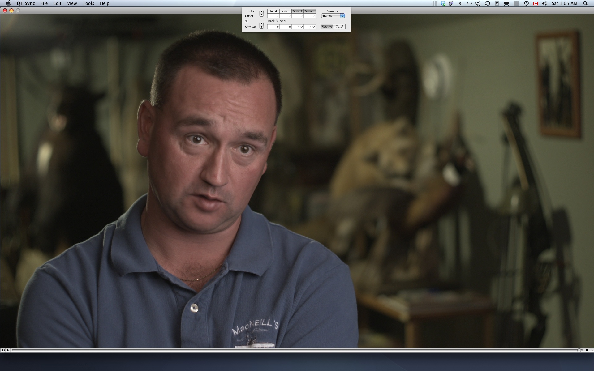

Had some help from Dror Lahat who suggested not to offset the audio but rather increase it over time like you suggested. *Went back and re-tried QtSync which is a free program found here:*QT Sync This seemed to do the trick and was able to get it close from the beginning to the end of the interviews affected.*
Using QtSync, set the DURATION values and "arming" the two audio channels for "17 frames," for an interview which went 59:57 minutes/frames. In a shorter interview of *27:05:12 minutes/seconds/frames it was 10.5 frames. t would be nice to get an exact formula as one has to guess and experiment until it looks and feels right on sync. Perhaps SD's engineers might help there. I was told they are looking into this, and may have an answers for those impacted soon. But for anyone struck by the same problem I suggest you try this QtSync method.
Initially, I entered the values in QtSync using the offset window at the top and could only get sync that way by breaking everything down into 3 minute segments. Not sure what the bug is, Sound Designs seemed to indicate it was something to do with the way the PIX interpreted PsF while converting to 23.98 using the PIX scaler, and recording that result to the SSD. Here's what Dror said he believes the bug is or was not that SD has corrected the bug in anything from 1.07 update up:*
"Remember that audio has no frames. Also, I eventually realized that the PIX wasn't adding frames to the video; the PIX has no capability for buffering like that, nor can it predict signal it hasn't received yet. What was the likely cause for the bug was inaccurate framerate (speed) metadata in the QT, at the Quicktime Atom level or something. I think the audio played correctly at 48,000 samples per second (or whatever audio settings were), but the video ran at 23.98fps instead of 23.976fps."
Everything we shot with the Mini KiPro was fine, but our long interviews the PIX stuff was alarming when discovered the sync problems. We chose the PIX because, using large capacity SSD's, we did not have to interrupt our interviews to change (very expensive low capacity) CF cards. Certainly it's fantastic QtSync could do this, when the paying programs I tried failed. The pic attached shows where I entered the values. You have to play with it a bit to figure out how many frames to enter when setting the "Duration" for both audio tracks. It depends on the the length of the interviews. The longer the interview the larger amount of frames you enter but you have to experiment with the number and just watch closely to see if the interviews are syncing with the lip movements.*
