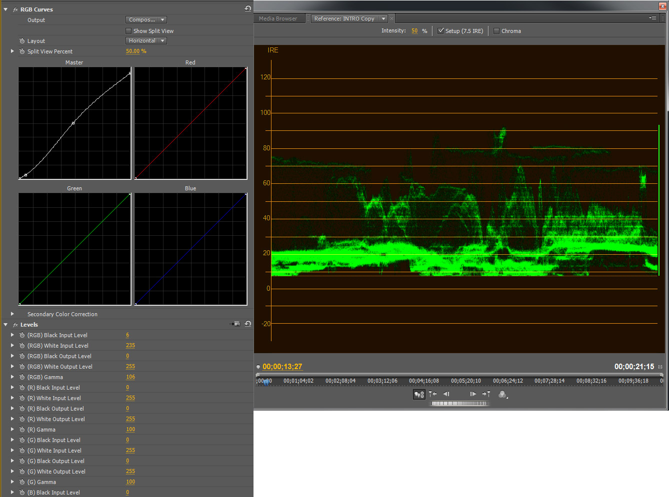

Hi Lenny,
Can you post a screenshot of the problem you are having so we can take a gander?
Here is an Intro I shot with the F3 + S-Log to SxS using the Rec709 (800%) LUT, and then using a slight "S" shape in the Curves effect (PPro) to boost contrast and then Levels effect to reduce dynamic range, which crushed blacks and clipped some highlights (see included image for what I did).
