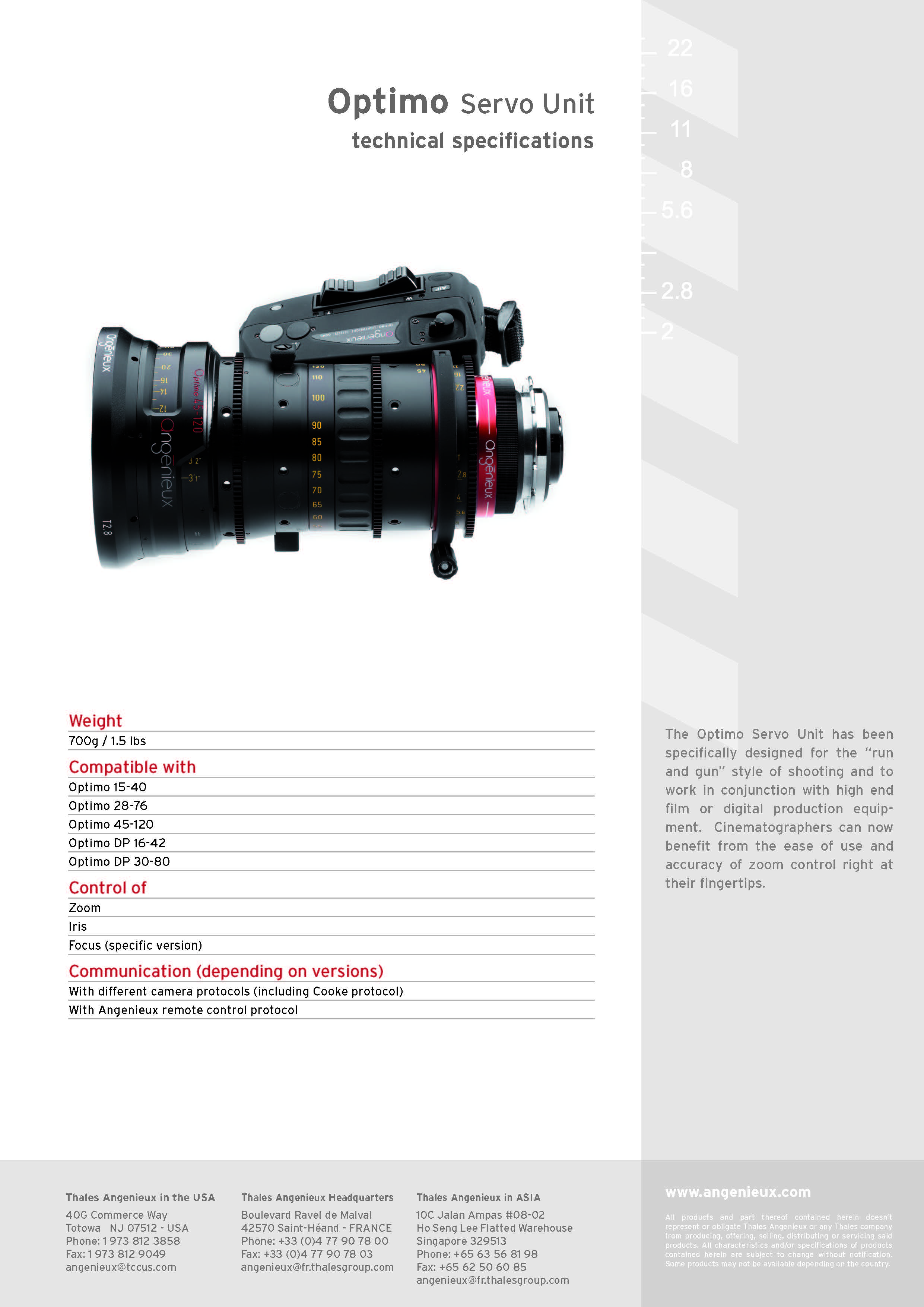

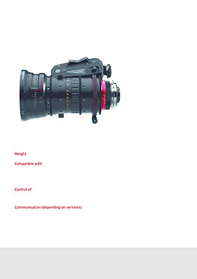

Here are jpegs of a PDF that I converted from the just announced Angx Servo controller. Fujinon also just announced a new Servo zoom lens 19-90 but its PL mount. It seems that the F3's ability to use servo lenses has spearheaded a new breed of cinema lenses (I think the Alexa Plus can also use servo lenses).
I have used the AbelCine adapter as well as their Viewfinder adapter and I loved every minute while using them. For comparison, I also have used the Sony servo zoom for the F3 but I did not like it at all because it was very slow, heavy and the iris ramping was a pain.
2/3 inch lens on the F3 / FS700-servo-unit4-1_page_1.jpg   2/3 inch lens on the F3 / FS700-servo-unit4-1_page_2.jpg
