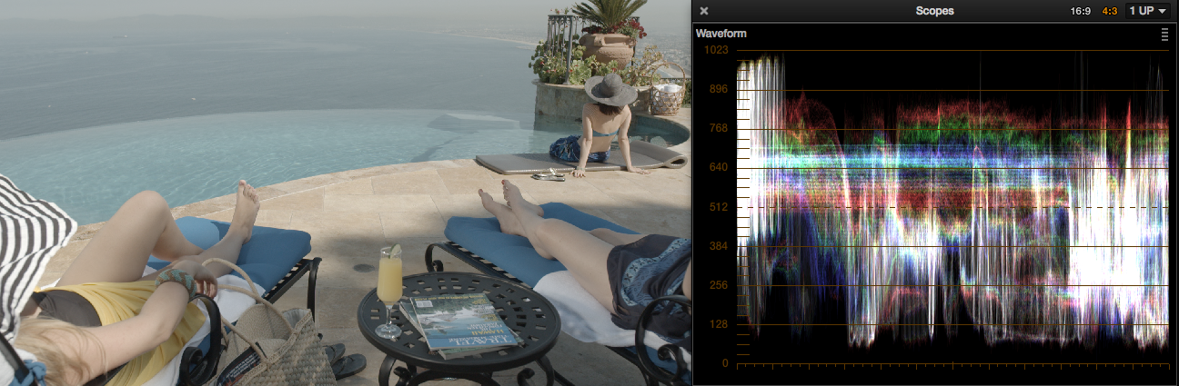

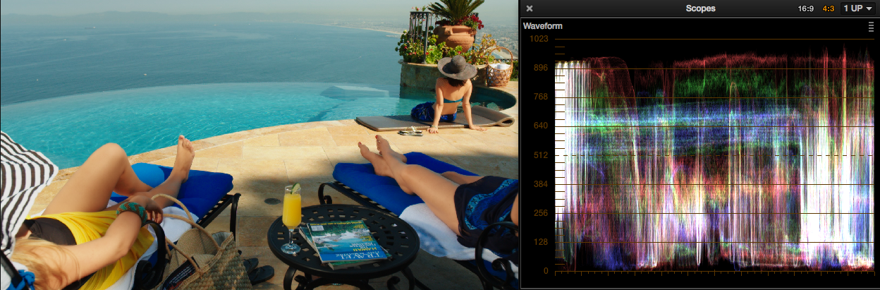

When you have a situation where your dynamic range isn't so wide, like an interior that's been lit (including fill light), the camera in S-Log has latitude to spare and you should take care not to overexpose. It's easy to do. In those situations, your exposure histogram will have some blank space on the right if you're exposing correctly. Put another way, if dynamic range is low, underexpose by a stop.
Daylight exteriors, if it's hard sun, and you're not filling in the shadows with lights or reflectors, you can actually hold sun side and shadow side if you split expose. And it will come out looking nice. You won't get the luxury of exposing it "correctly", in which you underexpose a bit and let the LUT in post bring things back to level.
If you do this, you'll likely be adding only a little contrast back in post as opposed to the former situation where you add a lot of contrast back via the LUT.
In the grabs below, I actually have Resolve adding contrast back via the LUT Resolve provides for Alexa Log-C, but I further tweak it so I can still keep my highlights from clipping. Applying the S-Log or Alexa LUT and doing no further work would have the whites clipping on the hat on the left.
Using Slog to shoot day exteriors, plus stars at night-slogwlut.png   Using Slog to shoot day exteriors, plus stars at night-slogwolut.png
