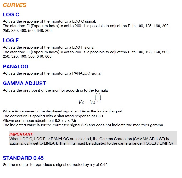

I'm using a Transvideo CineMonitor Evolution SBL8 monitor, Really great tool!
The screen has a tool which provides curves for log C, log F and Panalog. I asked Transvideo to provide S-log correction for viewable (rec 709ish) in these presets. They are very helpful and are willing to implement this. I was asked if I have the 'S-log description'. Does anybody know what this is? I assume some values to work out in a gamma formula.
Can some provide the correct data or a place where I can find this? In the attachment what the manual says about curves.
