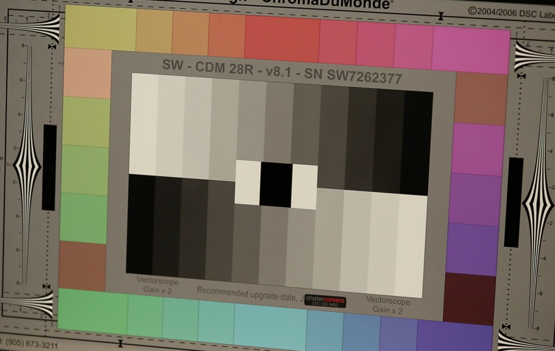

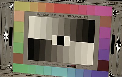

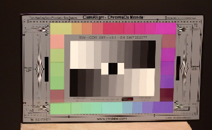

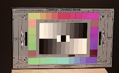

Thanks, Dave, I will check on the firmware versions. The SF crew used a Zeiss CP.2 50mm on the F3, while I've been shooting my F3 with a Leitz 50mm. Both 5Ds used the Canon 100mm primes.
The 5D standard Picture profile from Abel was loaded onto 2 different F3 cameras via sxs card, and both F3 cameras showed a distinct magenta tinge. Cameras were from Chater in SF.
I'm attaching the images the San Francisco DP sent me, thanks again for taking a look.
Tom
Originally Posted by Dave Sperling View Post
If I'm understanding you correctly, you're saying that the same picture profile is having a very different result in different F3 cameras.
I suppose the first thing I would look at is making sure that all the cameras have the same firmware version and are using the same lens set.
I'm going on the assumption that you are sending an SxS card with the picture profile on it? Or are you sending the master profile(s) as an electronic file?
Do you have anything standard (such as a shot of a color chart and gray scale) that was shot with the different cameras?
Issue with picture profile?-canon-5d-chart.jpg   Issue with picture profile?-sony-f3-chart.jpg
Thomas Kaufman is offline   Reply With Quote
