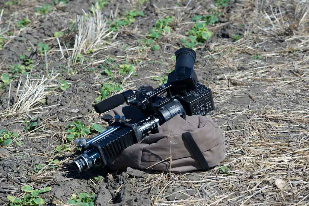

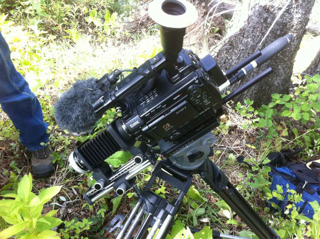

I have a 55mm Nikkor macro that I picked up on ebay for a good price. But I most often use a Nikkor PB4 bellows with 150mm bellows macro lens. Here is a shot of the set up on F3 and also on Sony FS700 this time mounted with 3 extension tubes. The longer lenses give you a little more room to work with. If I was looking for a fixed Nikon lens today I would probably go with the Nikon 105mm. Again there is often lots of Nikon macro gear on ebay or check with your local camera store used department.
Deciding on a Macro Lens-f3-bellows.jpg   Deciding on a Macro Lens-fs700-bellows.jpg
