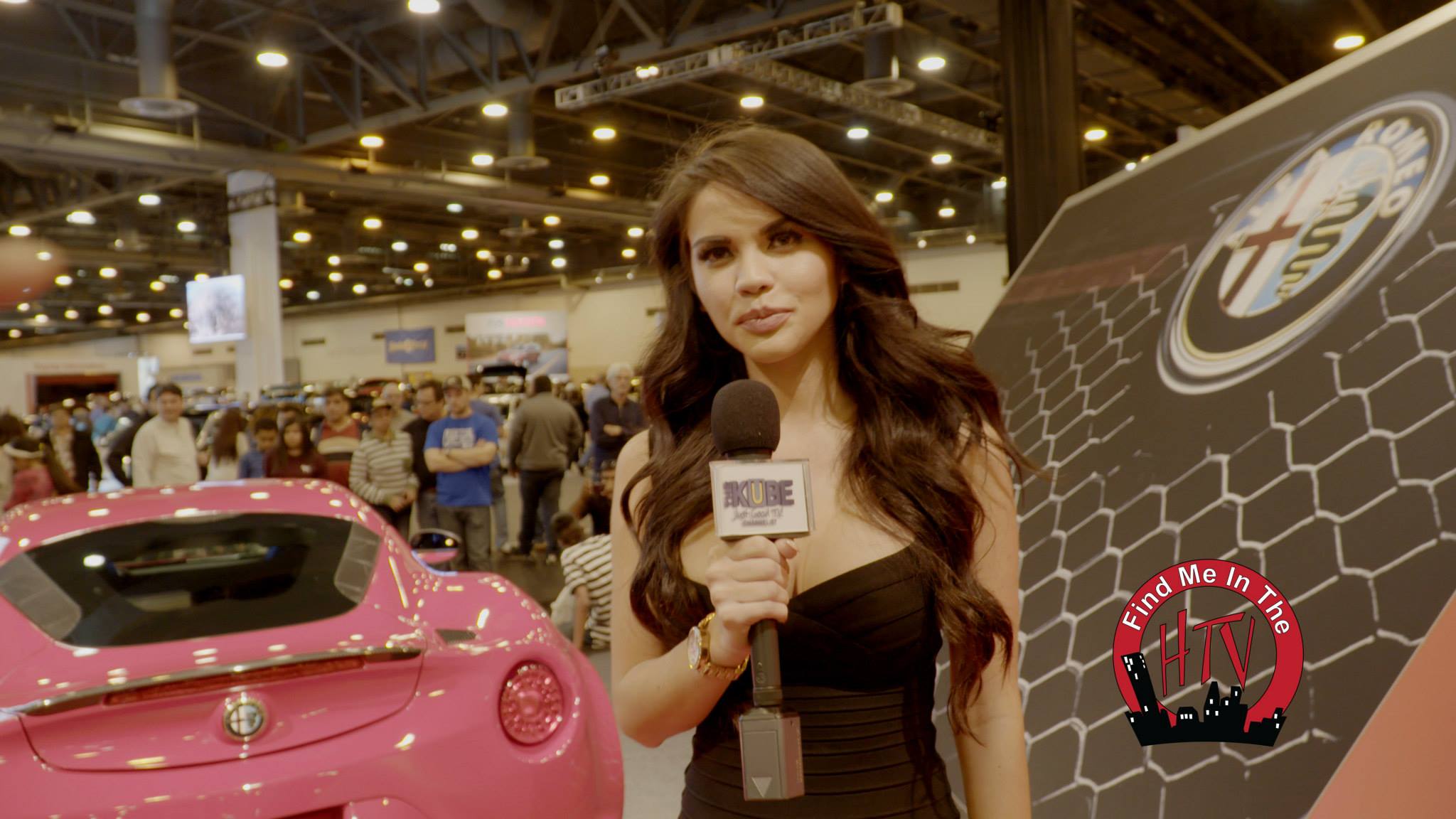

Pxw-fs7 problem with red
I was in a rush when I shot this interview at the Houston Car show. The RED car came out pink. I did notice the pink color when Ithe VID was shot, but I thought it was the Sony log and I could correct it in post. I shot an intervew of a RED Z06 before this one the color was fine. What did I do wrong ?

Re: Pxw-fs7 problem with red
I don't think that is a problem with the camera as much as its a problem with the light source. I bet the lamps they have in the building are not putting out much red.
I'd agree with Chris - those look like sodium lamps which traditionally have a non-continuous light spectrum and a HUGE green spike.
