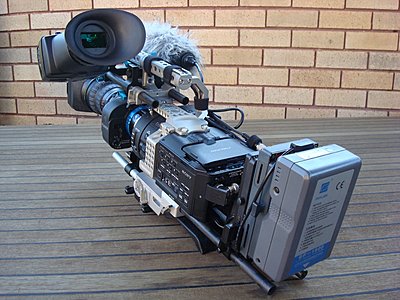

Yes you have to power the lens via a D Tap or similar but VERY IMPORTANT don't just plug it into a D Tap port on a battery otherwise you will fry the lens. It MUST be a regulated 12v supply. I'm using a Hawk-Woods regulated V Mount plate to power the lens. See attached pic. On the FS700 I've used the MTF B4 adapter for close to three years now. Mainly for slo-mo sports grabs but have done some full length football games with the setup and been quite surprised how good the results look. Not had one complaint from broadcasters. The MTF B4 on the FS700 does require a lens with a 2x.
The same setup on an FS5/FS7 shooting in Super 16 Crop mode should enable the use of a B4 without the doubler. The MTF adapter has a .5 objective in it as a 2.5 x magnification was required to cover the S35 sensor. By all accounts the MTF 0.5 adapter with a B4 without a doubler should work quite well.
MTF B4 on FS700

ENG/EFP with an FS7?-fs700-01.jpg

That lens looks great! No CA that I can see. How much was the adapter and the plate? I have an old Fuji BERM 14x lens that might work. Needs some servicing(iris has become stiff after years of dis-use), so it depends on how bad things are inside. Used to be a nice lens.

To be honest though if I was doing it again I would be buying any one of the much cheaper V Mount plates off eBay that have a regulated 12volt D Tap out.
You would also need a 12pin Hirose to D Tap cable to power the lens from the D Tap 12v output. These eBay ones are a fraction of the price that MTF charge for their equivalent cable.
Anton Bauer Power TAP D TAP TO 12 PIN Hirose Cable B4 2 3" Lens FOZ | eBay
One thing to consider. These B4 lenses are way heavier than any e-mount lens so you really have to run a rail support system to keep everything shipshape and tight. You could get away without rails but I would be very wary using it like that. All the necessary lens mount bits to attach to rails come with the MTF kit listed above.
As I said all in all I was pretty happy with the results considering the overall price of the necessary bits. If I go for an FS7 or FS5 for that matter I wouldn't hesitate to use this kit on either of those cameras. It's hard to get away from the fact that a good constant aperture parfocal servo zoom is a good tool to have. B4 lenses evolved into what they are today over a period of many years because circumstances demanded that sort of performance and flexibility for fast news gathering. To be able to use modern large format cameras with that sort of lens flexibility is a pleasure.
