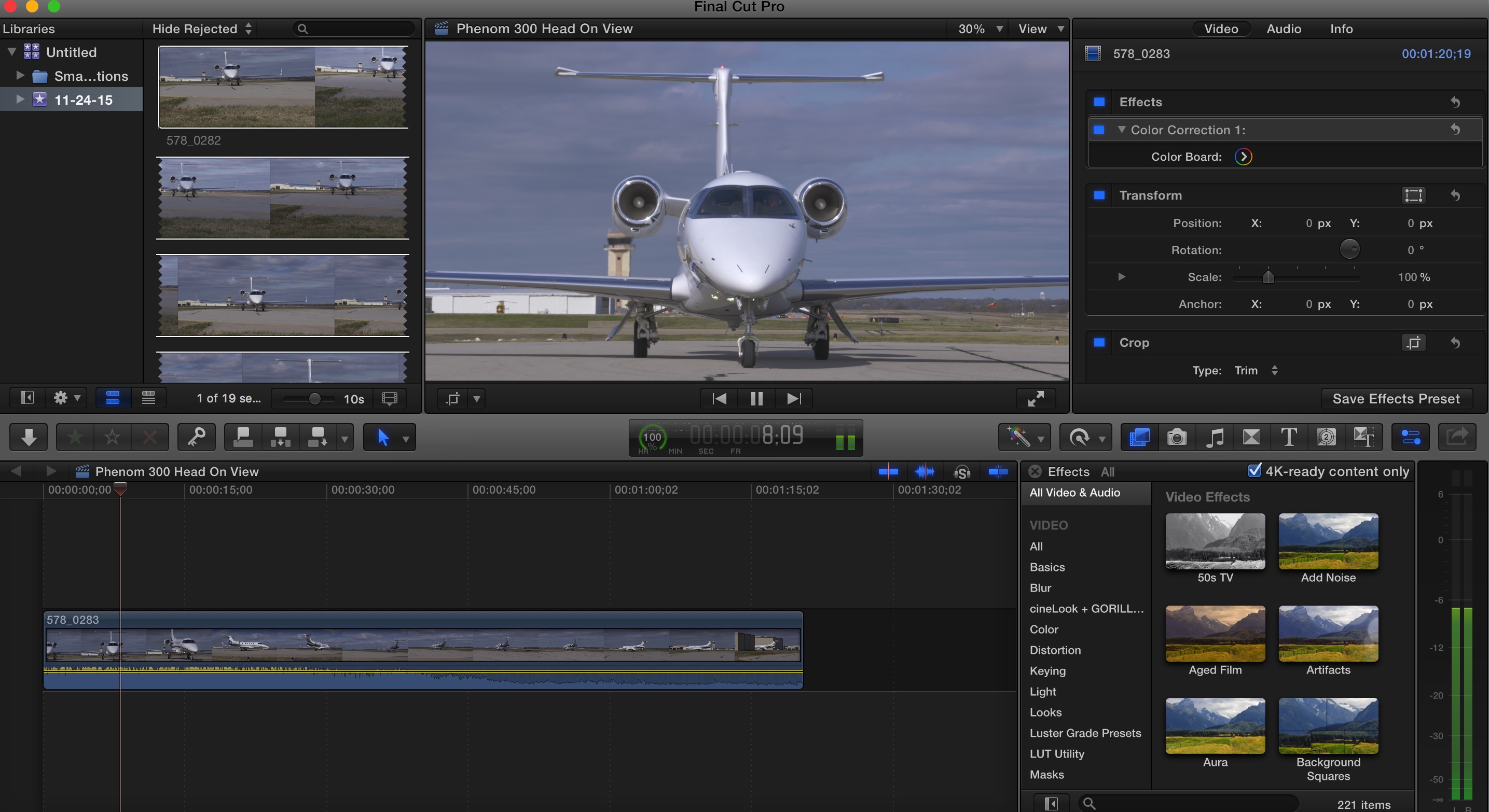

Being a relative newcomer to all things cinema, and my FS/7, I learn multiple things each time I fire it up. Apparently my audio is not set correctly because the jet engine audio is breaking up at the high end. I was working with the F/22 Raptor Demo team in August and I noticed a little clipping as they taxied close to me, less when they were performing above me. Today the audio was pretty much trash peaking at around -6 to -8.
