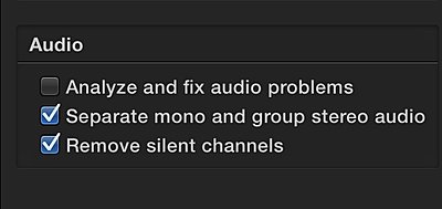

You can have FCPX not import silent tracks. It is just one of many import options. You set this up in the import window and it will stay for subsequent imports until changed again. I always strip silent channels.
With this setting you will just get 2 channels from the FS5 if there is audio on both. If only one had audio you just get 1. This makes life simple...

Old March 25th, 2016, 07:26 AM   #12
Vortex Media
Location: Florida
Posts: 3,563
Re: 4 channels of audio?
Thanks, Olof. That sounds like a great feature.

Since FCPX isn't track based the silent audio it doesn't show up at all in the timeline. But under the audio adjustments in the channel configuration all four will be displayed. That is where you can disable or change stereo or mono etc. But Olof nailed it, just don't have them import.
learn something everyday.
