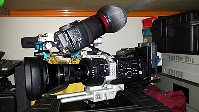

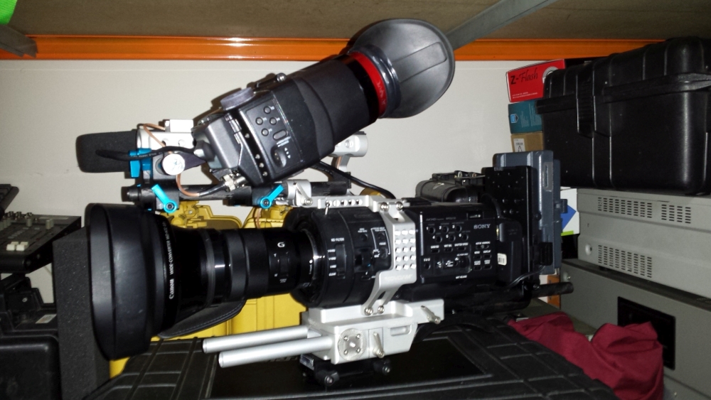

Old April 21st, 2016, 09:08 AM   #14
Location: Sydney Australia
Posts: 1,622
Re: 18 105 software fix
Originally Posted by Jody Arnott View Post
It feels a lot more precise. I'll be using this lens a lot more now.
After the upgrade it's even better on the FS700 now. For the price of this lens it's a pretty reasonable performer in spite of its manual focusing issues. All the same I'm sure that feels improved somewhat.
In conjunction with a machined down Canon WD-H72 0.8 zoom thru wide angle its become a very useful crisp 14.4mm - 84mm zoom. A poor man's Cabrio we call it :))
Chris Young
CYV Productions
Sydney
