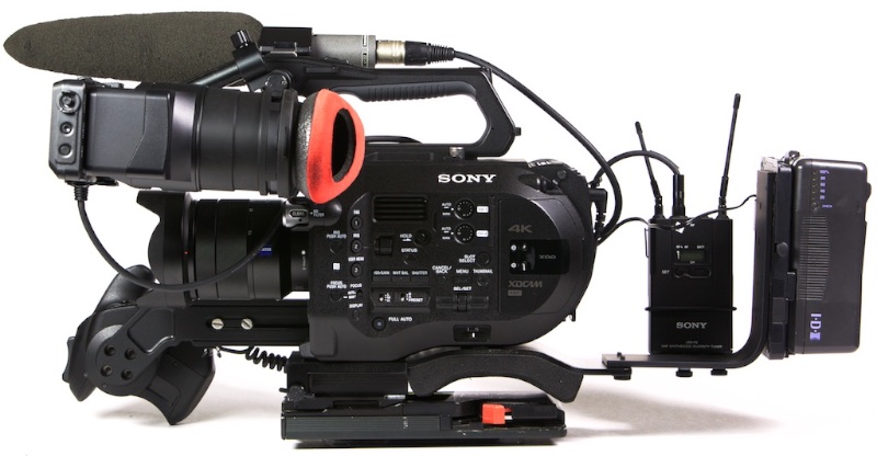

I was also thinking about selling my Sennheiser EW100 G3 set and getting the Sony wireless set but then I couldn't mount my cameralight on the hotshoe anymore... How do people solve this?

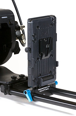

I have a couple solutions for IDX or AB (GoldMount) plates on this page:
Sony FS7 shoulder brace

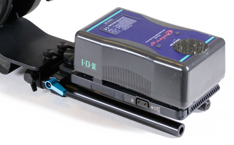

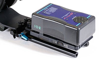

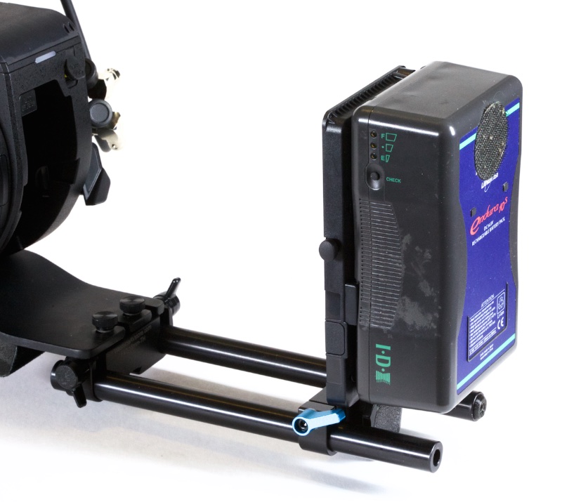

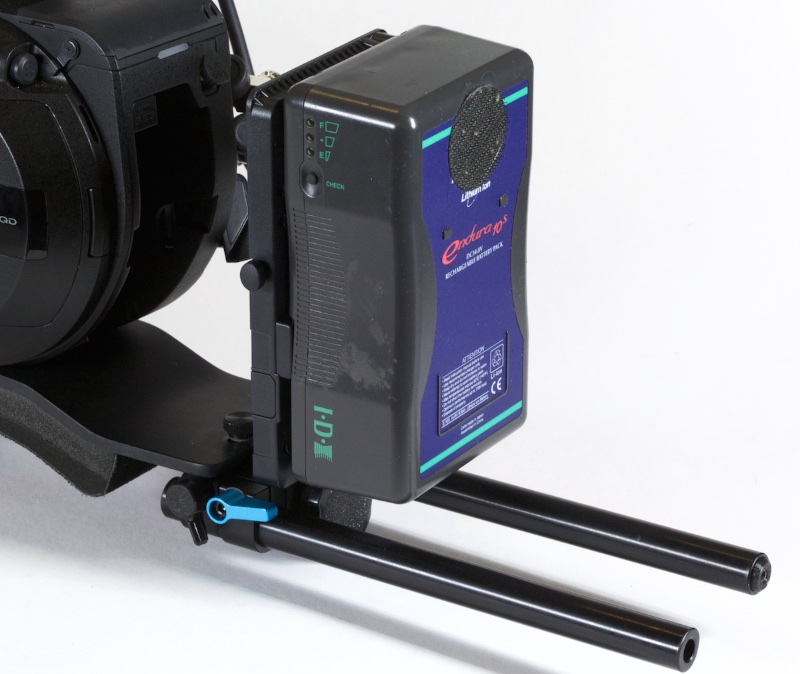

@Olof I looked at your FS7 cheeseplate with batteryplate and you offer specific batteryplates for IDX or AB.
But a plate like the Tilta for the FS7 has universal batteryplates, I assume. So why would one need a battery-specific plate?
One big advantage of your design however, is that you can slide the battery back and forth for balance.
www.imaginevideo.nl Just published the second of my viral mini-doc series '100'
https://youtu.be/ZqHFBrV-oOc
Jeroen Wolf is offline   Reply With Quote
Old April 24th, 2016, 08:59 AM   #14
Sponsor: Westside AV
Posts: 1,365
Re: Rigging the FS7
Originally Posted by Jeroen Wolf View Post
Thanks for the info. I figured I would probably never shoot RAW with the FS7...
Yes you can even lay the battery flat or invert it so the bricks low for even better balance, though this makes it a little awkward to put down.
There are 2 types of plates Goldmounts, I use AB plates for those, and V-mount I use IDX for those. These are all very high quality plates I have used for many years, some Chinese knockoffs are really bad.
