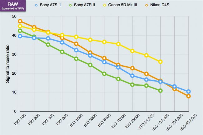

Alister Chapman wrote a fairly concise overview of the 8 vs 10-bit encoding noise versus signal some years back. I couldn't find a link to Alister's page on XDCam User but did find another link to it via HD Warrior. This is exactly how I have always understand the facts.
HD Warrior » Blog Archiv » 8bit or 10bit that is the question

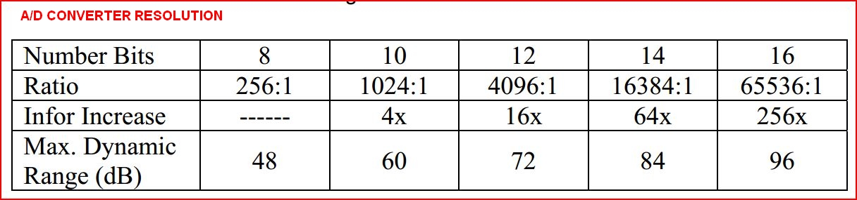

The Signal to Noise Reduction figure of the sensor's A/D converter output and the camera's electronic circuit is also an important factor in determining just how well a camera will reproduce noise free images be it 8 bit or 10 bit. To be able to reproduce a clean full 10-bit signal the SNR of the camera needs to be close or better than 60dB. There are very few cameras delivering theses sorts of SNRs across all channels RG and B.
Assuming the image could be read from the sensor with no other noise, an A/D converter’s
resolution can be determine from the following table.
Given the SNR of the A7S II is in the low 40s dB there would be no real advantage whatsoever of of encoding the A7S signal as a 10-bit image as you would be encoding a lot of unecessary noise which would not be included in the encoding when encoding to an 8-bit signal with it its maximum dynamic range of 48dB.
Another thing that is obviously going to help the image noise figure in Dougdale's tests is the fact that he is dropping a UHD image on a 1080 timeline which creates a reduction in visible noise levels by a factor of four. At a lowly 4K the video image of an A7S II looks amazingly good for an 8-bit camera. Put the A7S II up against some of its competitors in high resolution still images well in excess of 4K and then you see its shortcomings in relationship to SNR with its color depth and dynamic range falling behind even the old Canon 5D Mk III
Sony A7S II review: Lab tests: Sony A7S II signal to noise ratio | TechRadar
Sony A7S: Best Low-Light ISO score in our database - DxOMark.
Not withstanding all of the above I am extremely tempted to go for an A7S II as in the real world it delivers very satisfying images price for performance.
