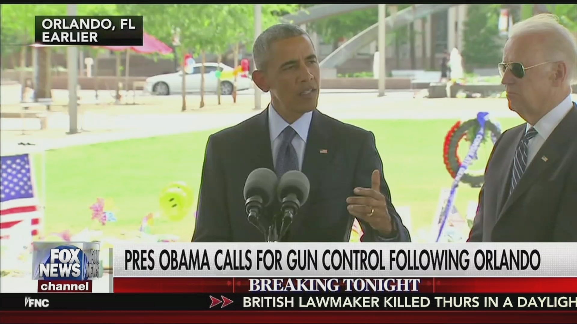

Originally Posted by Doug Jensen View Post
You know, it's really easy to come up with all kinds of unique situations where standard exposure techniques won't work very well or where creative decisions or judgements about setting the exposure may be the only choice. Should I give you my examples too? What those situations come down to is exposing for the most important subject in the frame, and everything else is allowed to suffer as necessary. Fine. I do that too. Every pro does.
But those extreme examples aren't the norm and isn't really what this thread about. I'm addressing the other 99% of the time when there are rules that must be followed, there is one correct exposure, and there are fast, quick and easy techniques that can be used to ensure consistency and accuracy. That is what I am talking about. What happens the other 1% of the time is not the norm.
This just aired tonight across the entire US. You have darker color skin on a dark suit under a shady roof with some intense sun behind him. Scopes show 100 IRE slammed up there VERY hard. (graphic is taking up allot of that space too) You can image what his 100% zebras look like in that background. I'm betting there is allot more harsh white in the scene behind that lower third too.
Is this that rare "1%" that you are talking about? Is this "properly" or "correctly" exposed in your opinion? Or, should he have pulled those highlights down and pushed the president's face and his suit down to the bottom of his scopes?
Me?, without being there myself, I'd guess he did the right thing. He was forced over pretty badly to protect the important object of his shot. I also don't think this is in any way a "rare" 1% problem when shooting outdoors.
Just my humble opinion....

Doug Jenson - "So I'm going just to voice my opinion that a lot of the info being posted on this thread is dead wrong -- or would only be applicable in the most unusual situations -- and really have no bearing on the other 99.9% of situations we find ourselves shooting."
In a few posts up, we have a dark skinned president giving a speech under shaded cover in front of a very bright street and park. That background is blown out dirty style. I can imagine that guys monitor with zebras all around the president. I feel for that camera guy but he HAD to get the President. He just cant bring the background in range and turn Obama into a faceless, talking silhouette.
Do you think this is a rare or "unusual" problem? I think we have all been in stuck in this situation a million times in our lives!
It's NOT about "guessing" or "eye balling it" either. When you are over or under exposing,...YOU KNOW IT when you are doing it. Most of the time you are gritting your teeth and saying "damnit!" as you are doing it. Obviously, if we are all paying attention, we all know full well when it's happening but we do it anyway for a "REASON".
Yes, there ARE "reasons" to under and over expose and they are not "rare" when shooting outdoors.
CT.

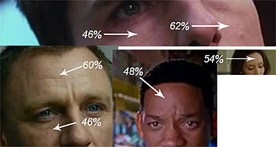

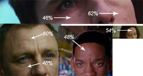

And while it is also correct to say that with Rec-709, 90% reflectance white is represented by 90 IRE, it should also be remembered that Rec-709 is a DISPLAY standard, not a camera standard and in fact 90 IRE is also supposed to result in an on screen brightness of precisely 100 nits. But 100 nits in a typical daytime living room is very dim, so most TV's get cranked up so that 90 IRE is much, much brighter, typically 300 nits with a decent LCD TV. So if we are adjusting the display to compensate for different viewing environments should we not also adjust the exposure brightness for different capture environments. 90% white is a very useful engineering reference level to know, but it is just that, an engineering reference.
Most of us will be aware that daytime TV shows tend to be extremely brightly lit while evening chat shows lit less brightly. A large part of the reason for that is because during daytime viewing brighter images tend to look better while in the evenings in darker living rooms lower key scenes are more pleasing.
I always find it a quite fascinating exercise to download a few movies or high end dramas and look at where white is or skin tones are. White is rarely 90% and skin tones are typically around 50%. I've attached some samples from a few randomly selected movies that I picked a few years ago. Skin tones fall between 45 and 60%, so that means white would fall between 65 and 80%, yet I doubt anyone thought these movies were under exposed.
The human visual system is very good at adapting to differing brightness levels. Show it something we know from experience to be white and it will accept it as white over a wide range of on screen brightness levels.
Doug: You call me an "engineer pretending to be a cinematographer". Yet you are the one taking the engineering approach to a creative craft. Always expose white at 90% according to the meter. You can't get a more engineered approach to exposure than that. (Why oh why Doug do you always have to resort to derogatory comments, personal attacks and put downs when people offer alternate approaches).
A huge amount of the TV and film production community choose to expose differently to that. These are not people guessing, dead wrong, spewing bad information nor are these rare or uncontrolled circumstances. These are extremely experienced people at the top of their game.
